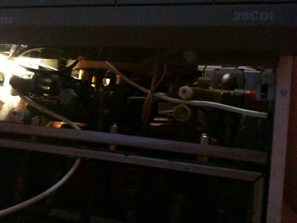

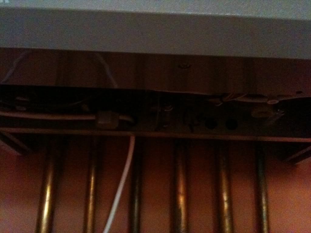

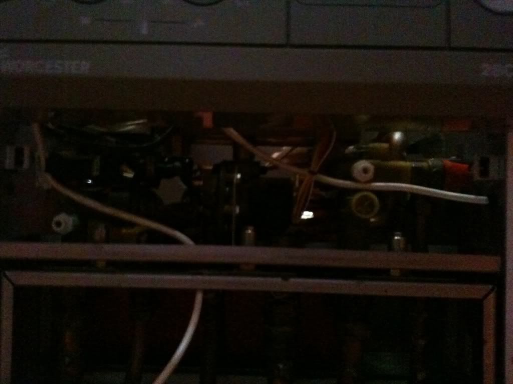

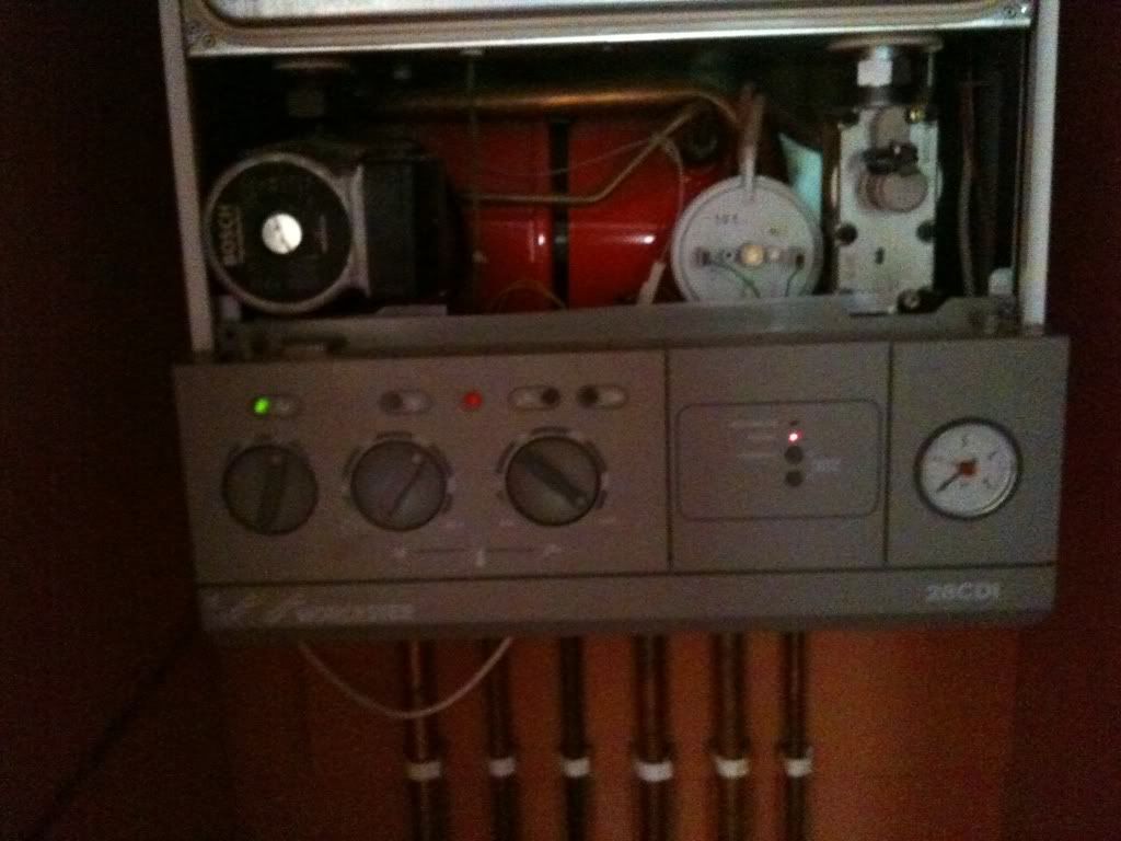

Right, here is the boiler in question. Sorry for crap pics and poor light conditions though.
The pressure relief valve is the red knob on the right according to the installation instructions. It says to turn it anti-clockwise to test, but it just turns out, then clicks back in sort of like a manual ignition switch for the pilot light.  :undecided:
The instructions to set the system pressure says to put a key into the filling loop housing and twist in place. (The large flathead bolt type thing that is under the grey pipe as your looking at it.) Its held in by a retaining clip and even removing this does nothing. It then says to turn the grey knob anti-clockwise to allow water ingress and fill the system until the pressure gauge shows 2.5bar. I'm assuming its the grey bolt just to the left, but this just pisses out water.
Hope you can make this out guys, thanks again.  :smiley:

Is there like a plastic thing to put in the  loop as it wer ?
So you can turn it , like a screw driver

There isnt a filling key that I know of, I just used a flat head screwdriver to turn it
is it the grey nob? left or right.?

http://www.newtonnet.co.uk/house/boiler/servicemanual.pdf
page 23  :sad:
it has a built in preasure vessle , so its not a new combi.
my only knowlage of unvented is hotwiter storage system, unless there is a "nipple" like a car tyre on the red vessle?
