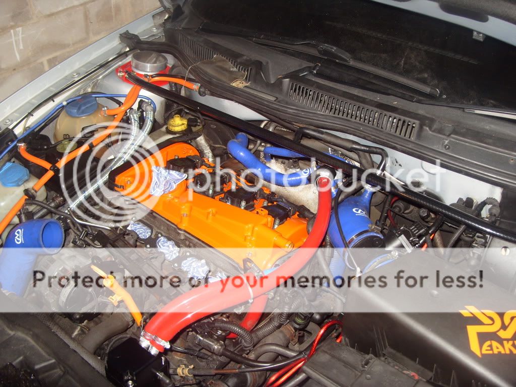

what do they do ? stop the oil from the breathers being put back into the engine ? how are they fitted ? any pics would be great ?
thanks
the catch can is the 1 with the redpipes going to it

thanks for the pics.  :wink:
