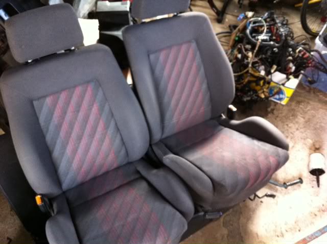

Offline minimat
  • Posts: 137
Re: mk1 1.1 formel E to 20valve turbo project thread
« Reply #89 on: 24 February 2012, 14:04 »
new seats
still need some 100mm drive flanges
mat
