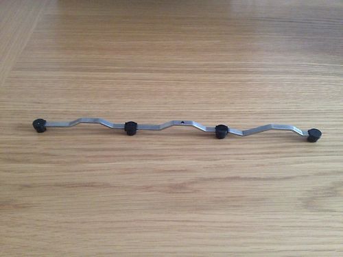

well its been a while, but the old girl has gradually been giving me issues to the point is now BELLOWS black smoke out you heavy right foot action.  :shocked:
infact its not far off this  :laugh:
to the point people are now flashing me  :lipsrsealed:
the problem was located this afternoon, the swirl valve bar has popped off and the fixings are fcuked  :rolleyes:
can you buy a new one from Vauxhall, can you fcuk, unless it comes with a COMPLETE INLET MANIFOLD  at MEGA £££££'s :rolleyes:
this is the item in question
So a quick google, search of the vectra forum and a trip to german ebay has located a suitable replacement
hopefully be here this week sometime, til then is smoke screen central and 35 MPG  :shocked: :cry:
then its the joy of trying to get all 4 lugs located in a very tight space  :laugh:

WTF is that and WTF does it do?!
Offline JC
  • Posts: 13,393
  • Back in the North.
Re: Old whistler, now a SMOKE generator.............
« Reply #466 on: 11 August 2013, 20:58 »

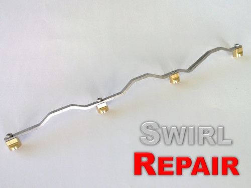

4 swirl valves on the 16v 150brake smoker
no3 is powered by an actuator
the bar is connected to all 4 and moves them accordingly, noramlly the actuator sticks but mine is fine.
the sockets on the bar are worn, and it falls off,  hence the GERMANS making a much improved version, its the same issue on Saabs, Fiats, Pauxhalls, to name a few.
all explained by the joy of google translate from http://www.swirlrepair.com/
