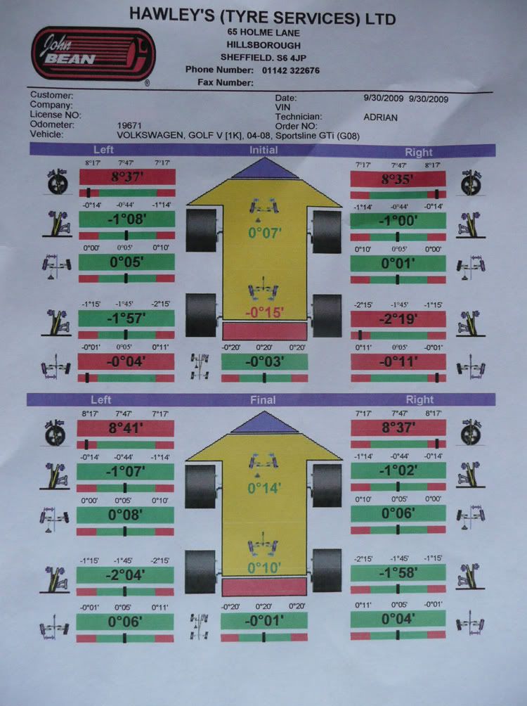

My before and after settings.  :cool:

That's really helpful for me too - cheers. :)
