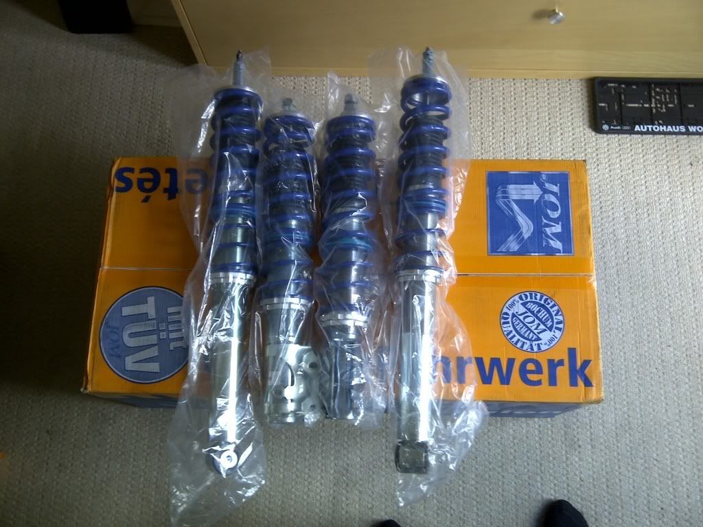

and to top it all off i have just recieved this through the post
now all i have to do is work out how to set them up  :laugh:
Re: DAN'S GTI VR6
« Reply #34 on: 16 August 2011, 15:44 »
Easy to set them up, front ones around half way, rears fit as they are, then see how it sits.
Don't forget to copperslip all the adjuster threads before fitting, will save them seizing up.
cheers mate, thats easy enough then lol! iv got plenty of copper slip! defo cant be doing with them seizing up like!
i know alot of people will probably comment saying i should have gotten more expensive coilovers etc etc but these are all that i could afford and im happy never the less! lol

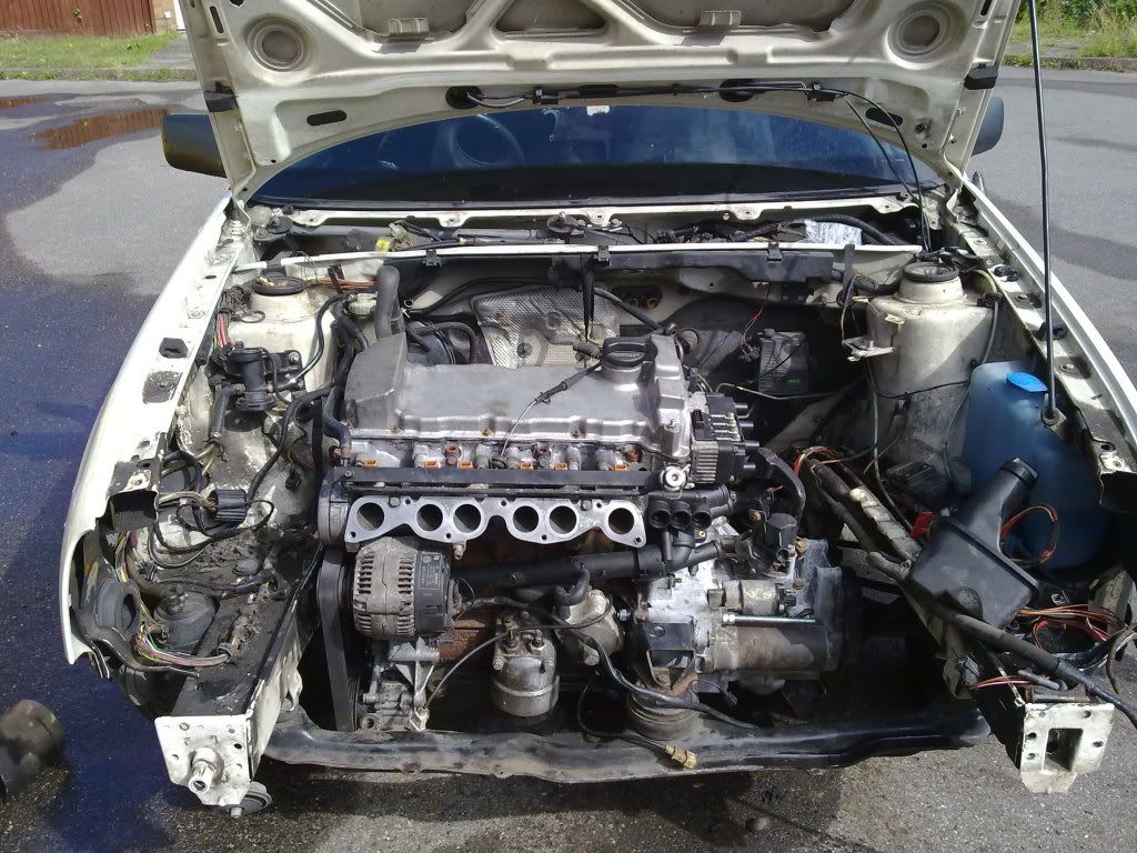

Went to install the new suspension yesterday and the nuts at the top of the suspension are totally corroded so am going to have to think of another way of getting these out.
so in the meantime i decided to do this:

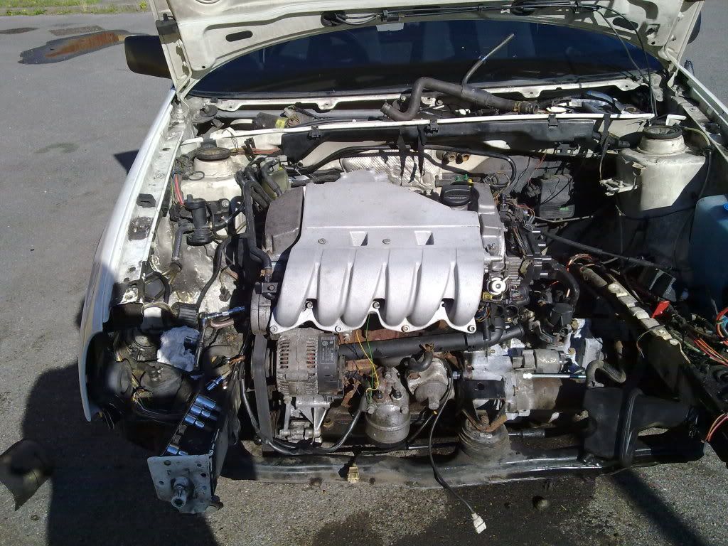

Thats right iv got the old girl in. im really surprised and pleased at how much space there is behind the lump compared to the 8v, goes to show how far forward the vr sits.

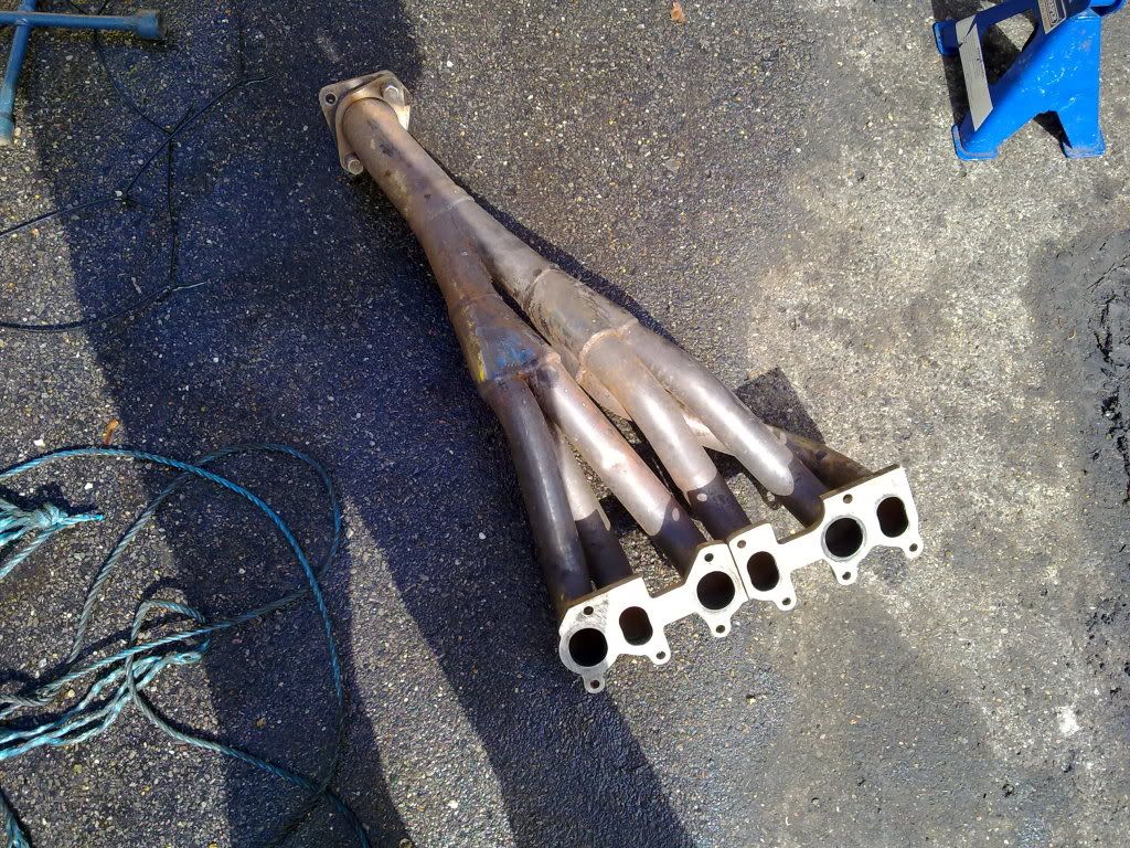

then it was time to stick my stainless manifold on
Put all injectors in and the fuel rail on. then got the wiring sorted for the rail, went to put the inlet manifold on and it wouldnt fit and then realised that where i had the plugs on the injectors facing upwards they needed to be facing towards eachother, once i had figured this out it was time to get the powder coated intake mani on
so what i have to do next is work out all the coolant hoses and where each one goes, and the same goes for the wiring. i have noticed one problem, my new radiator fan motor has a massive oval copnnection for it, where on my 8v one it was a small rectangular connection, so im thinking would my old motor run the new fan? or is it a simple swap of the plug on the loom? hmmmm lol
