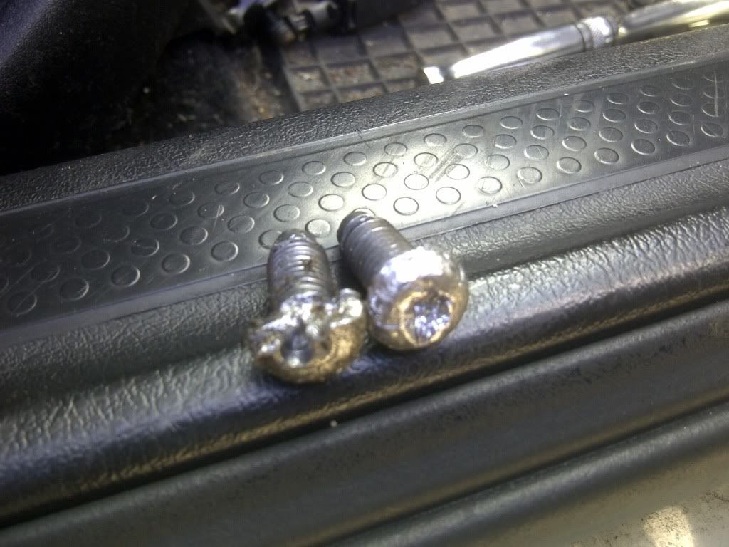

here is the state of my shear bolts
Re: DAN'S GTI VR6
« Reply #11 on: 08 August 2011, 12:59 »
^^  :shocked: :shocked: guess I was really lucky then.

Looking good, good process. I gave up on my sheer bolts in the end, gonna have another crack tomorrow, tried punching and punching and punching.
Will resort to cutting them out I think, haven't tried it on the car I'm keeping though!

Mate sometimes you get lucky! This time I didn't! Lol!
