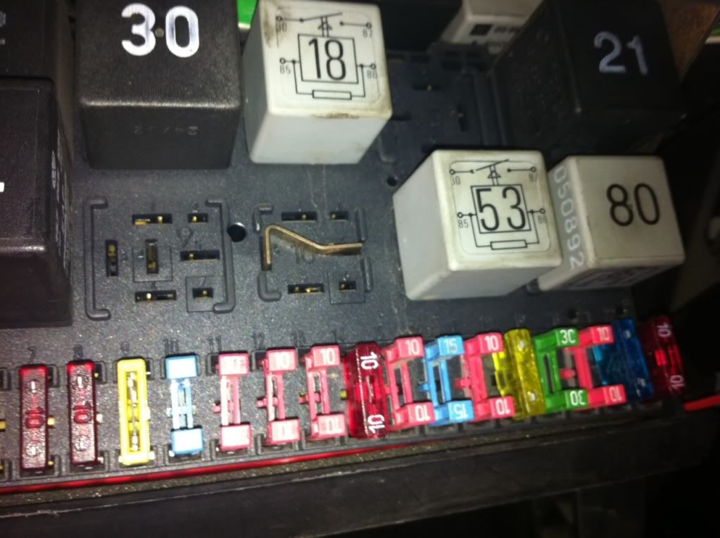

I have a second hand Mk3 from 1992 (from Spain) the air conditioner does not work (and I sure will do a good use of it), also I'm not an expert in car stuff by no means, I took it to have the gas reload it but it's not working still.
I checked the fuse and relays box and a lot of relays are missing, one being the air condition relay, here are some pictures:
Can some one tell me which one is the one for the air con, and which type of relay I have to get?
And also the other relays missing, can someone tell me which ones (and what are there for) are missing and the kind of relays I have to get.
One last thing: since there are missing do I have to be careful once I restore the relays?...maybe the took them out for a reason?
Thanks in advance.
Offline trog_nfs
  • Posts: 975
Re: HELP! Air Condition + more relays missing in Mk3
« Reply #1 on: 03 August 2011, 10:25 »
Heres the link to boneybradleys electrical page, shows you which relays should be where.
http://www.golfgtiforum.co.uk/index.php?topic=74087.0
Looks like you're just missing the air con and "headlights on buzzer" relay
