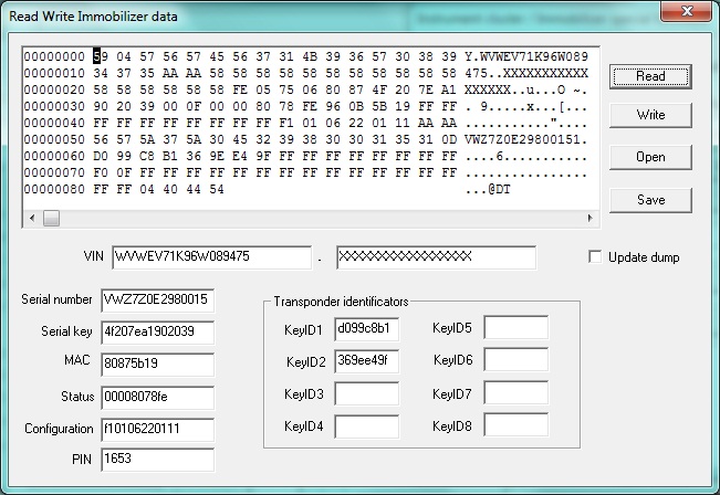

Well i got some clocks from USA for £80  mine (962d)   USA (972E)
I took them apart and changed over the faces so they looked like uk clocks.

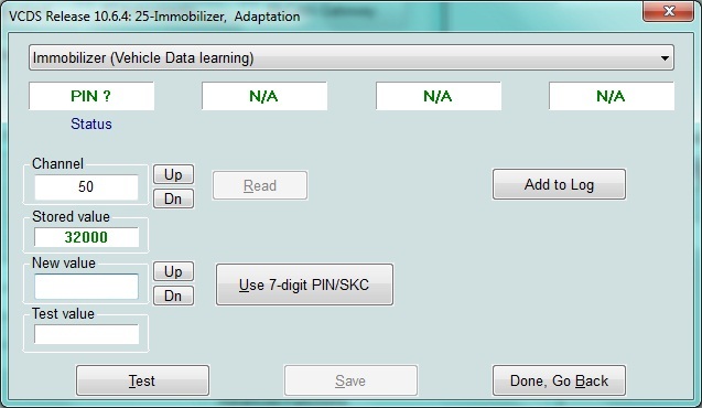

Backed up all the information with VCDS and pulled pin with can commander.
Installed new clocks pulled the pin from them no problem.

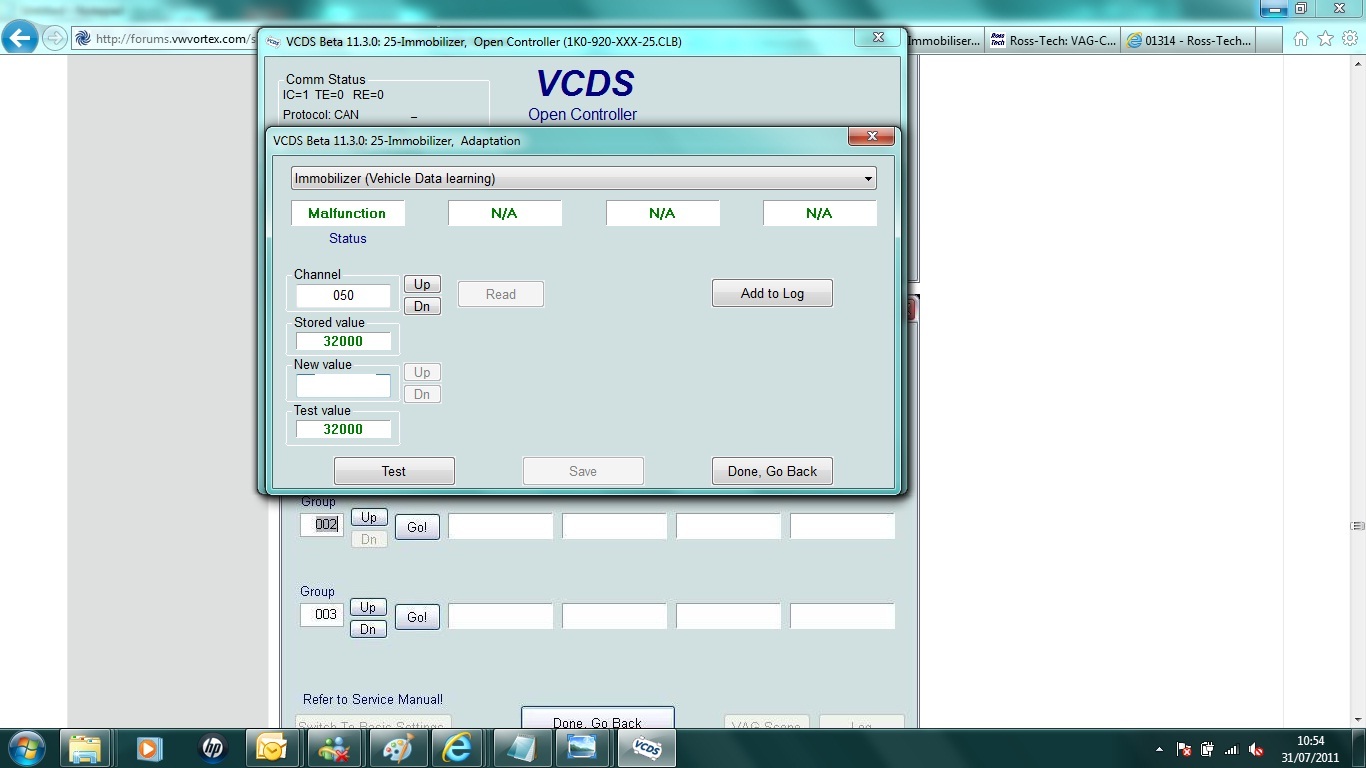

But i cant get the immobiliser to deactivate as the new clocks won’t let me modify the pin  :scared:  It just status malfunction :(
I have tried to back up the BIN file from my old clocks and restore it to the new clocks,  but as soon as you turn the ignition off it reset back to the old config
any ideas please  (  My old clocks are dead :( i left them outside in the rain last night in a rush and they are socked :(  opps i have left them drying out)
