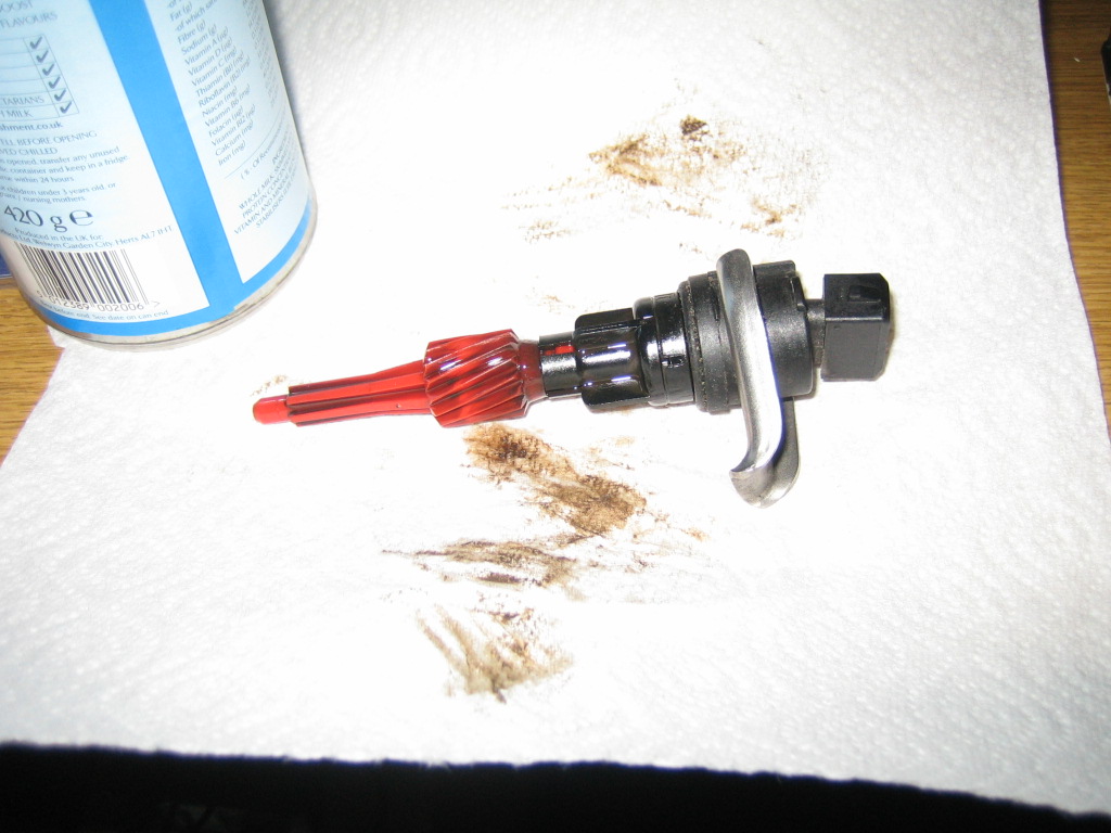

madsingh
Posts: 97
Re: help speedo
23 April 2005, 19:47 »
this is wat im talkin about

the beast
Posts: 20
Re: help speedo
31 August 2005, 21:17 »
knacked sender in the top of the gearbox like mine need a new one from dealer only £43
fit in 2 Min's with a 5.5 Allen key
get mine Friday so 2 days with no speedo
till a camera gets me
