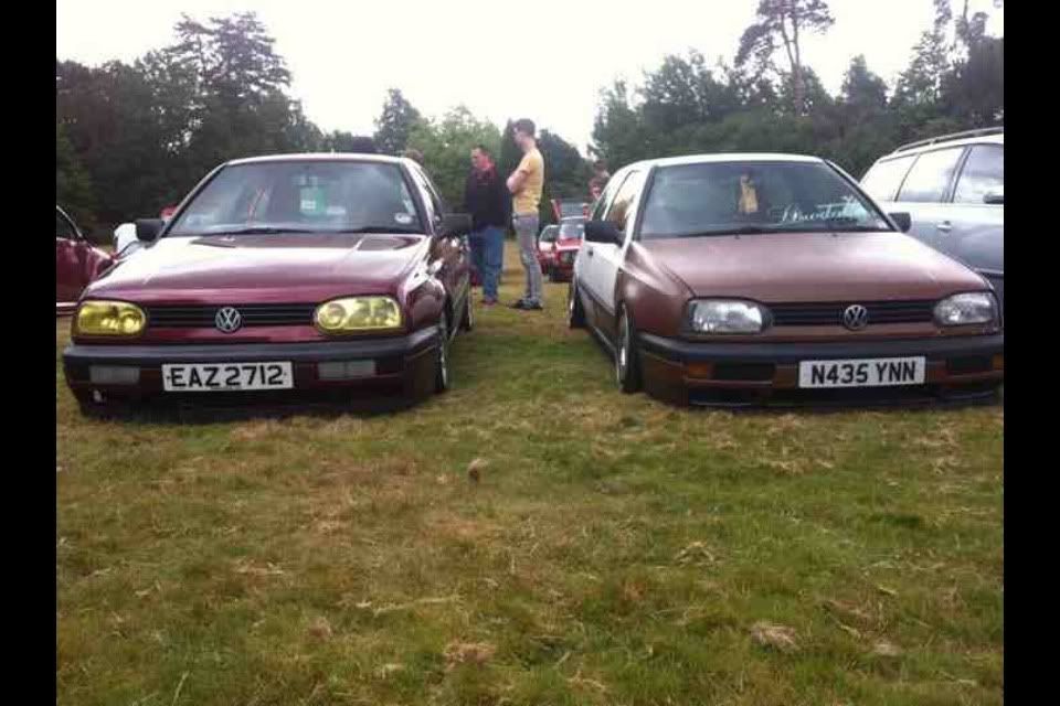

mine is on 8jx16

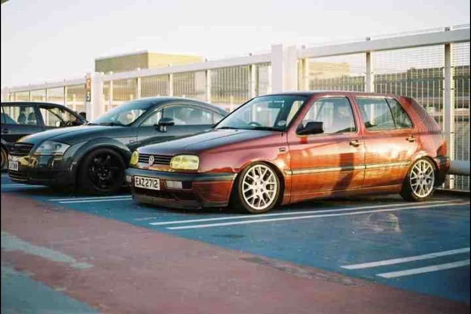

around 100mm, had t pull the arches a nit to get it so low, got 25mm spacers and 30mm spacers and the rims are 8" wide.
rubber is 195/45/16

Mines not as nice as that, but down on 16's. Got 40 profiles on the front and helpers out of the coilies.
Essentially mate, you can get on the floor without a lot of hassle. Will just need to sort your arches and be careful of drive shafts if you're running really low as they will rub.
