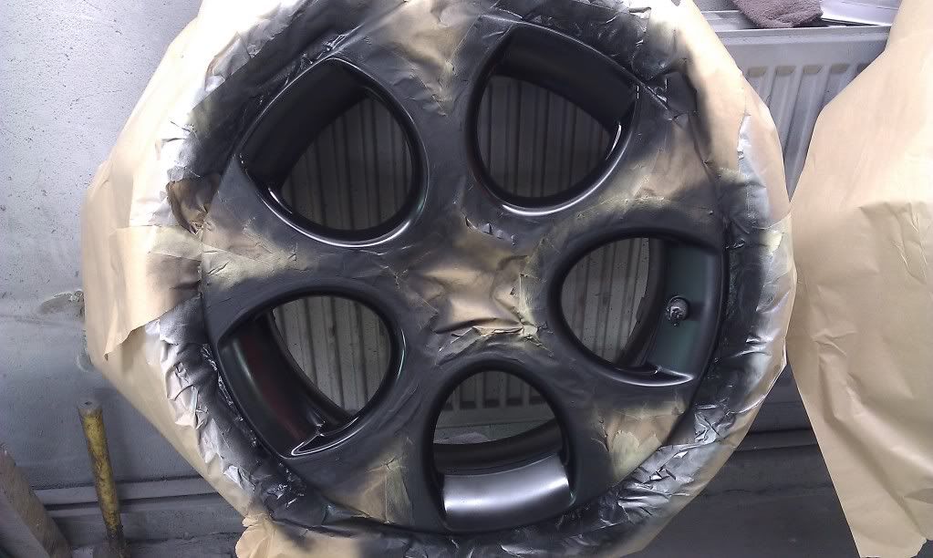

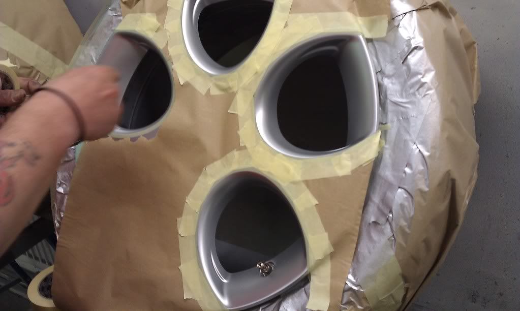

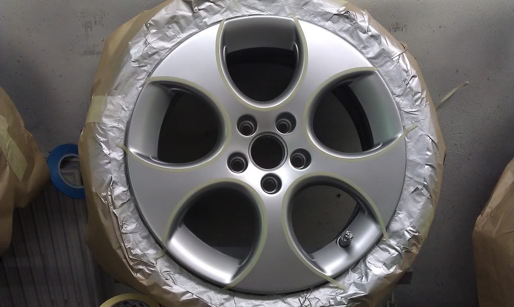

when i bought my golf gti a while ago i had the basic 17" alloys on, due to funds being tight at the time ,i decided to make the standard 17"s look like the black center monza style wheels !! here are a few pics of the stages of work . here is the wheel all rubbed down , and sprayed in moondust silver, then with 3m fine line tape, mask around inside edge for the black spray all sprayed up with matt black then peel off all the masking tape , followed by two coats of laquer !problem solved .i will never have any problems with these wheels whiteworm,or laquer peel or flacking !! the only way these wheels will mark is if i hit a curb finishing result !!

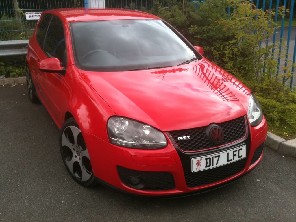

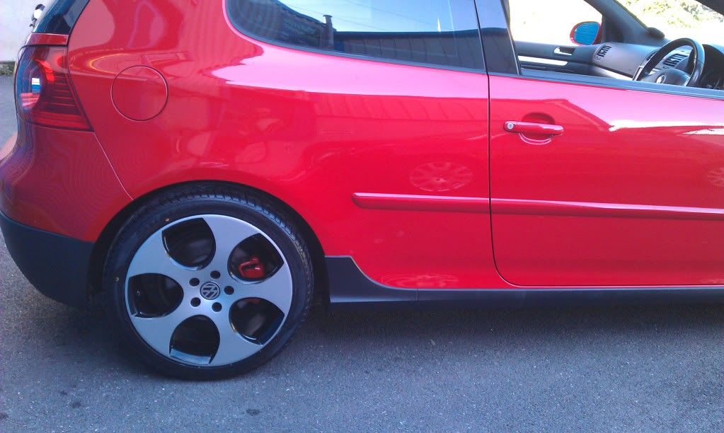

since iv done these wheels,lucky for me a set of 18" monzas came my way !! they were in very poor condition but done the same process. here she is with the 18" on . :smiley: :smiley: :smiley: :smiley: :smiley: :smiley:
