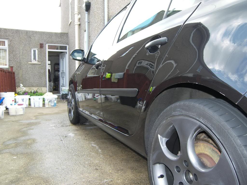

The car before I start

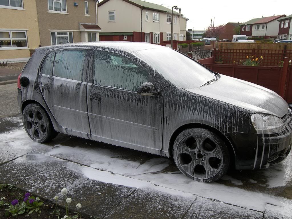

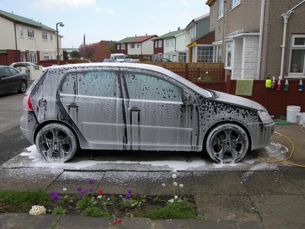

I started by giving the car a spray down with the orange pre wash, this was then blasted off with the pressure washer and then the car was given a thick coating of foam made up of Valet pro snow foam and a shot of Megs hyper wash, grills and gaps cleaned with a small detailing brush.

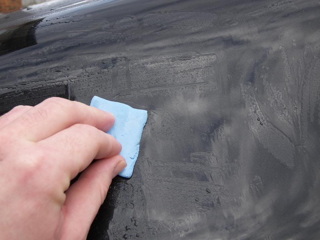

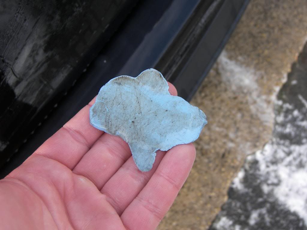

Whilst this did its stuff I cleaned the wheels using a weak mix of bilberry wheel cleaner and various wheel brushes and the noodle wash mitt, no need for a strong approach as wheels are in a mint condition after just been powder coated. No pictures of this though, this was then blasted off with the pressure washer, and then the car was given another coat of foam and washed using Meg’s hyper wash and the 2 bucket method and a sheepskin wash mitt. The car was then rinsed off using a open ended hose and left wet before claying using Meg`s last touch and clean your car’s ultra fine blue clay bar then rewashed using the same method and dried using a spray of last touch and uber microfiber drying towel.
Various marks around the car noticed as I had worked my way round the car claying

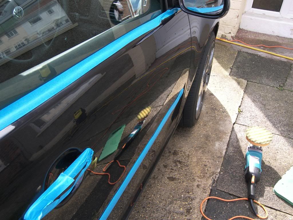

The car was then taped up using 3m masking tape, a couple of quick 50/50 using the lime prime and 3m yellow polishing pads before getting on with the rest car
Then started to work my way round the rest of the car

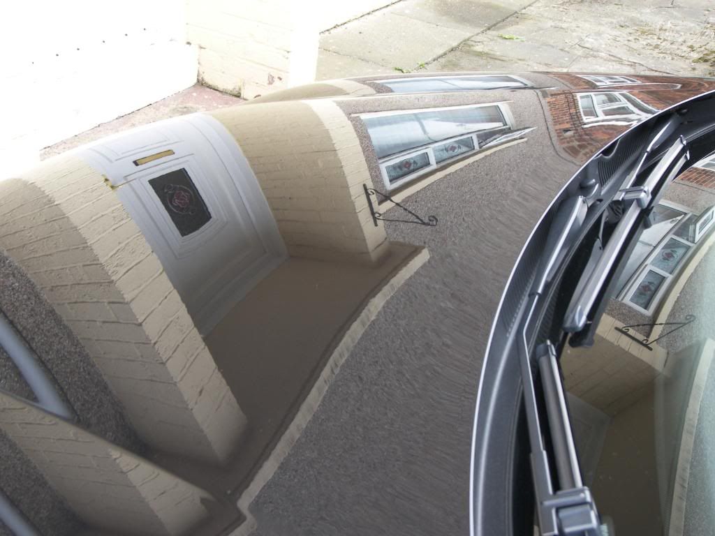

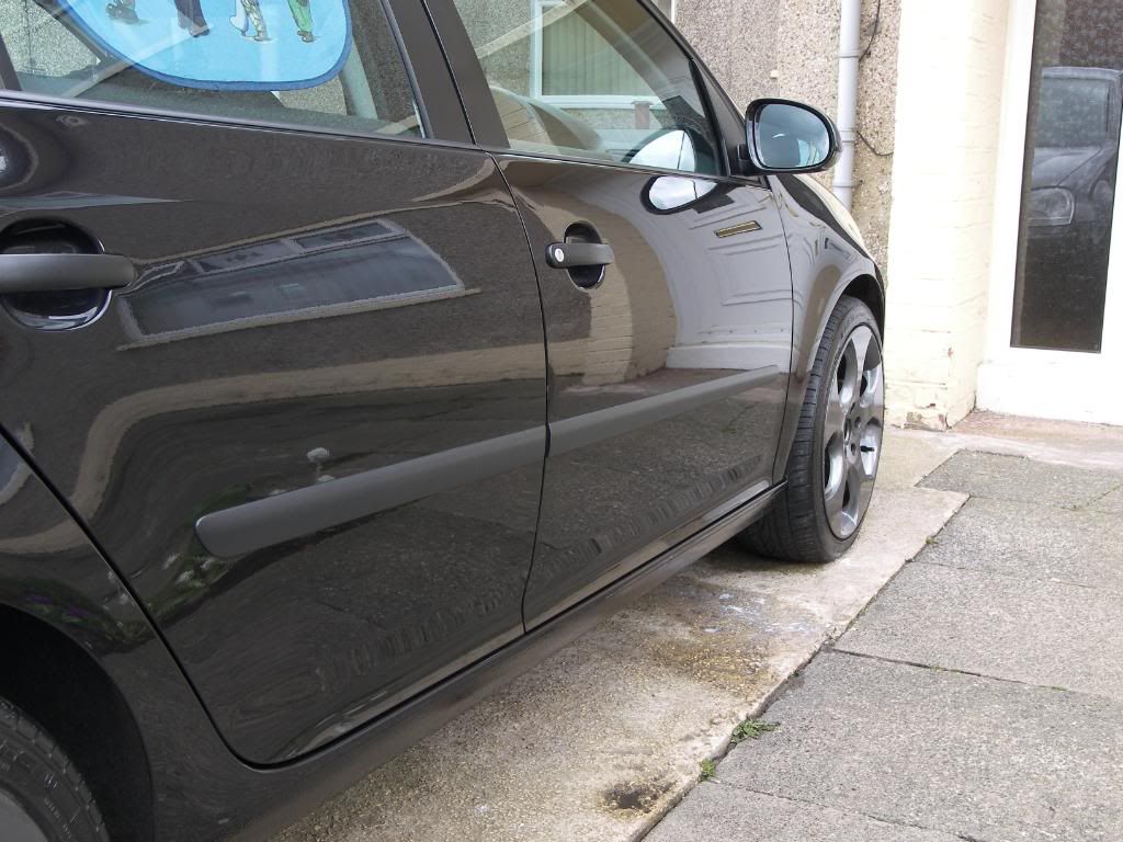

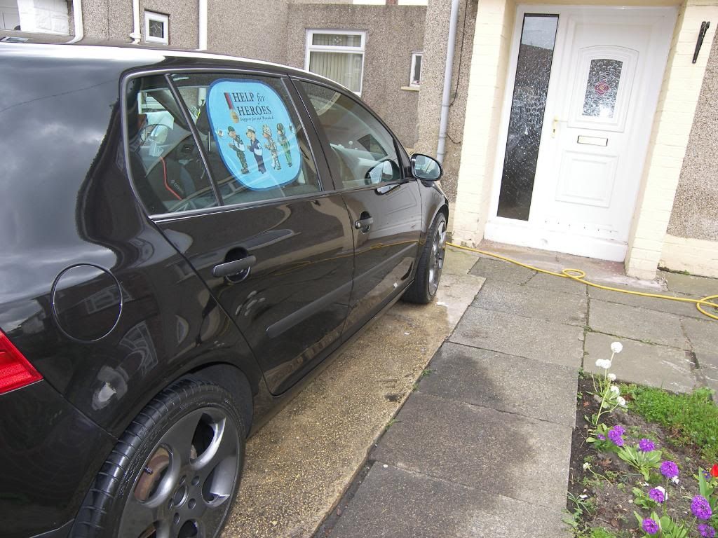

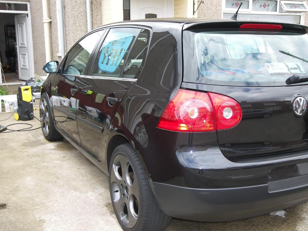

Some reflection shots
The wheels were given another coat of Jetseal 109 and the arches where given a coat of Meg`s hyper dressing and the tyres giving a coat of Valet pro tyre dressing. All glass cleaned with neat Valet pro citrus bling.

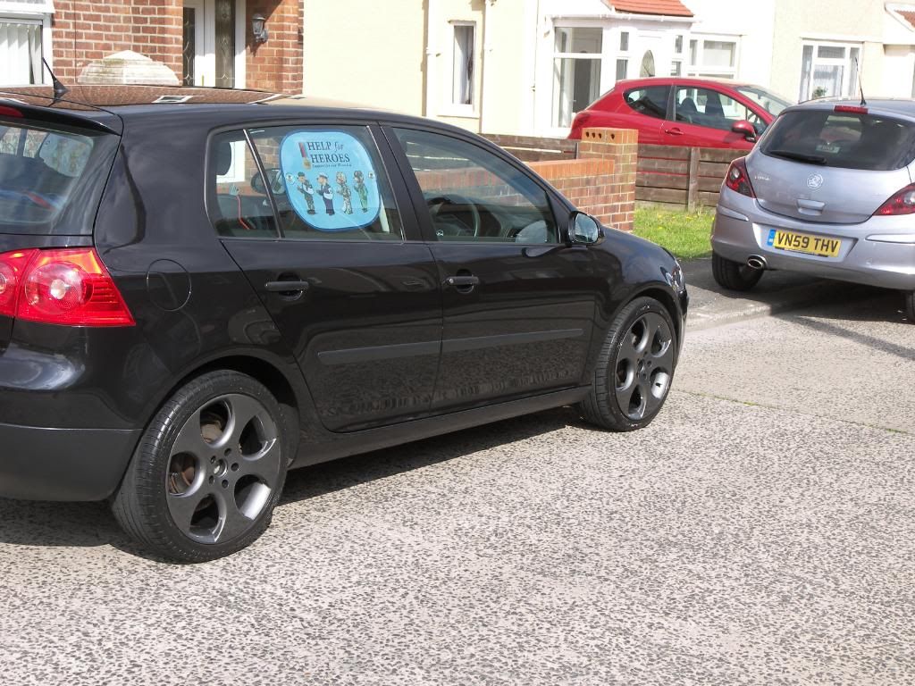

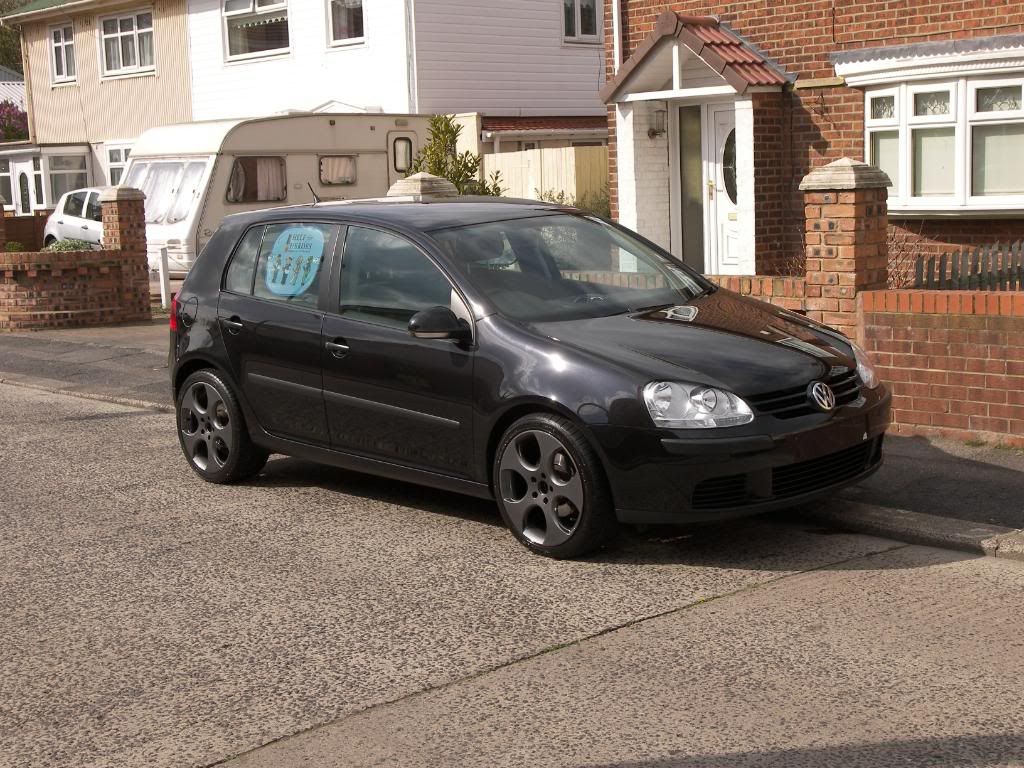

Leaving me with this.
