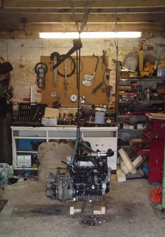

Right - some significant progress has been made!
I managed to source a brand new non reconditioned AJM engine for an absolute bargain price.
I've been building it up over the last few weekends and managed to get it back in to the engine bay yesterday!
Just a case of plugging things back in again now and firing her up for the first time.

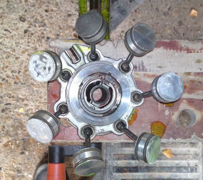

also a little challenge; can anyone guess what this is?

Hopefully almost done! found that the injector from cyl3 is shagged... no wonder the injection timing was such a pain to set!
collecting a replacement today and chucking it in, fingers crossed it'll do the trick!
Offline NoCrap
  • Posts: 71
Re: Smoke & misfire - Sorted!
« Reply #17 on: 02 November 2011, 19:50 »
Had one final issue of a faulty injector - fitted a replacement last weekend
car now runs beautifully!

whats the second pic then.....?

Well - as no one seems to reply on this part of the forum.... it's the internals of an air conditioning compressor - a fantastic bit of engineering and just show why they cost so much
