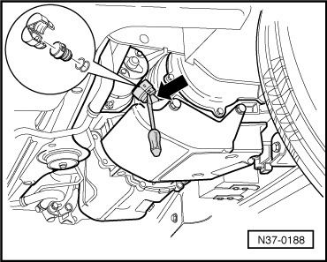

Checking and topping up ATF level
Topping up ATF
‒ Lever off plug securing cap -arrow- with a screwdriver. When doing this the cap locking device will be damaged, therefore always renew cap.
‒ → Pull plug out of filler pipe.
On some gearboxes a cap with a spring retainer is installed. This cap can be used again.
‒ → Fill with ATF using V.A.G 1924, until ATF runs out of level hole -arrow-.
An insufficient ATF filling as well as filling to excess affects the function of the gearbox.
‒ → Fit new seal to level plug -arrow 1- and tighten to 15 Nm.
‒ Fit sealing plug on filler pipe until the spring retainer lock locates, or
‒ Fit plug on filler pipe and secure with a new cap -arrow 2-.
‒ Lock cap.
Always renew cap. The cap secures the sealing plug.

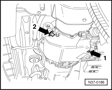

Yeah thanks. I believe i'll have to buy a ne cap. Or if i am carefull enough will my model have a reusable?
What the hell is that number one pointing to?
I beleieve the gasket is gone on this tranny as i remember crawling under it when rotating the tyres.
That means ill probably need to buy a new gasket and replace it.

« Reply #15 on: 09 June 2011, 10:10 »
You fill no.2 with ATF, no.1 is your level plug.
Basically put ATF in no.2 until it trickles out of no.1.
As for the ATF, make sure you get the correct spec, whether its from a dealer or motor factors.

Ok I understand now.
So the cap for number two I can pick up at the dealer?
For number one-i need to just buy the gasket?
