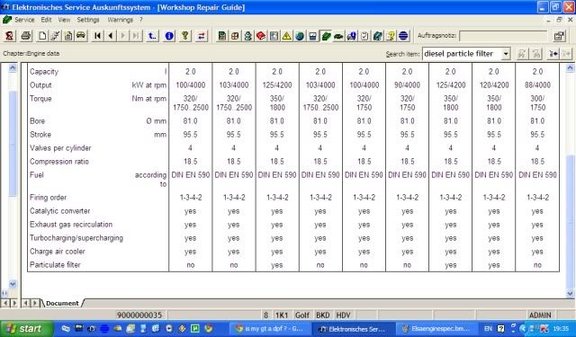

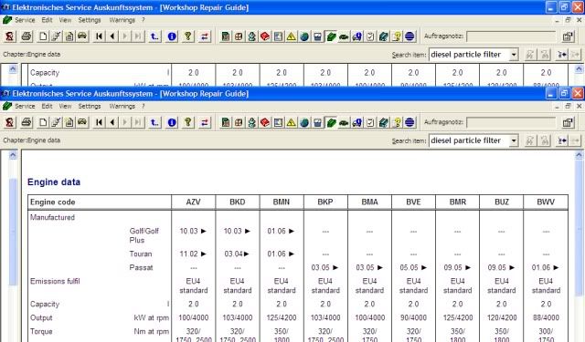

Just looked through 5 pages with the heading "mk5 golf 140pd dpf" but no hits as to the dpf on the 140pd, although other VAG cars do have it on the 140 and the 105 on the Audi A3...
This is off Elsawin the bible,  if you think the GOLF had a dpf on the 140pd then you need to speak to VW and tell the tech they should throw Elsawin in the bin.
Hope you can make sense of this but basically it is showing that only the 125Kw/170hp Golf had the DPF.
Darren :wink:
