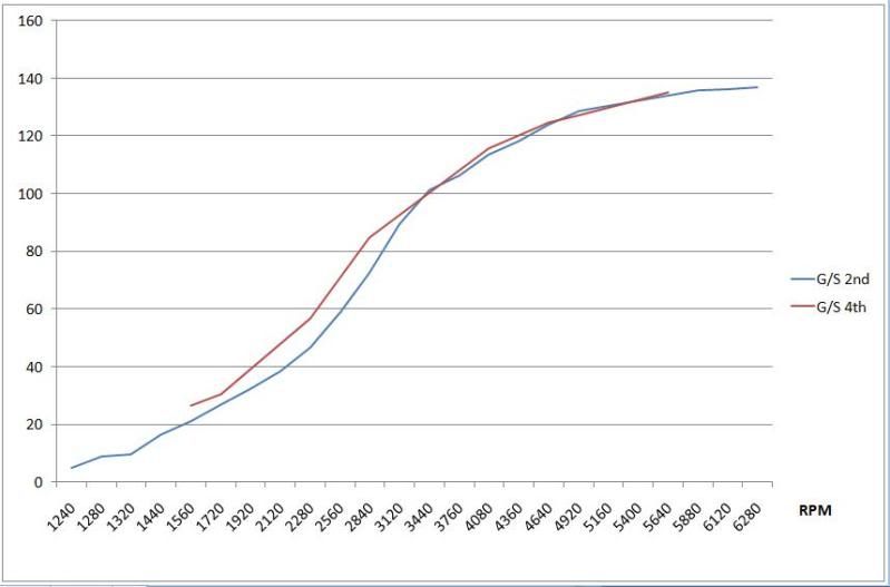

I tell a lie, mine was 138..
Look at post from R-tech to, doesnt make that much difference as long as requested and actual match!
Should be somewhere near 170 G/S if remapped right?
We ran a Revo spec1 AGU with a fault N75 today and it pulled 107g/s via VCDS  and 149bhp via the dyno.
So in theory 107g/s @149bhp is around /.72
So 138g/s /.72 could work out to 190bhp?
Just been looking at my vagcom logs v customer dyno graphs and the average for around 185-192bhp is about 154g/s -160gs

Very low reading for k03s??
That was on KO3, be back up your way shortly with Wazzzer to go custom  :wink:
