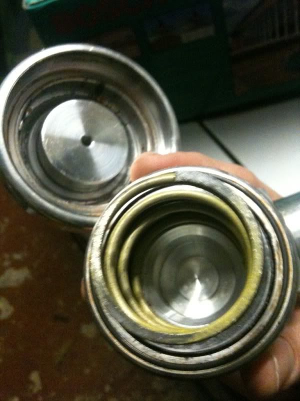

I am mega pissed, after all my FMIC progress my car on full throttle is juddering, no fualt codes, no leaks, noyhing. After nobing around I realized the DV was not shutting on full throttle as that is what is causing the juddering as its constantly opening and closing.
I took it out and it has not been touched since the 007p was fitted by r-tech to find *drum roll* no spring!
Now I'm pissed due to incompetence and the forking out of new springs at a silly price due to not fitting it correctly in the first place. Plus they are not local, the hassle of going up there and trying to dispute it seems very pointless.
My rant for the day!
Just wound up as I took a friend along with his 1.8T for a remap. I gave them more custom as I could of went AMD etc... They didn't scan for codes, smoke, test, clean TB/turbo as advertised and when I questioned this they replied along the lines: "we see 100's off these cars and continously work on them, so we know them in and out, so if any problems where there we would easily pick them up".
They work on these so well that they forgot a spring and didn't pick up on it.
Now I'm thinking how accurate the rest off the work is?

Dam thats annoying.
At least you know whats wrong with it now  :smiley:

Dam thats annoying.
How much are new springs bud?
Quick look on flee bay suggests £18  :cry:

£18 isnt too bad though i know ide be pissed off if i had paid someoneto fit it and found this, maybe give rtech a call/pm, they might re-imburse you the £18 through bank transfer or through paypall.

No spring? Damn.... Now you know why mine felt faster  :laugh:
Just had a look for my other spare red and green springs and can't find them.. Think I must have threw them out with the old DV  :sad:

give them a ring and tell them to send you one in the post! accidents happen but surprised it didnt run bad at any time it was on boost not just full throttle

Anyone got a pic of a 007p apart as I looked at the service kit my mechanic suggested, I can see the grease for the piston, spring and what looks like o-rings which are not on my DV at all?
