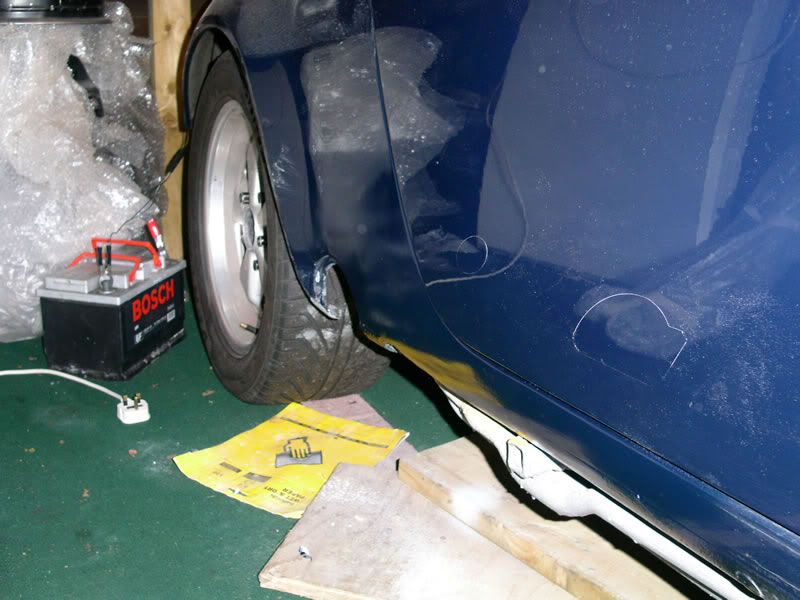

Take your time and practice on some scrap.  Also the cleaner the steel the easier it is to weld, remove all paint and every piece of rust before welding any new in.
Get tooled up too, I found one of these a godsend, Black & Decker Powerfile
Also a Dremel or similar are very useful for removing small areas of rot when a 3.5" angle grinder is just too big.
Like I said take your time and get tooled up, this is what I did on my 911, I'm not a metal man at all.
