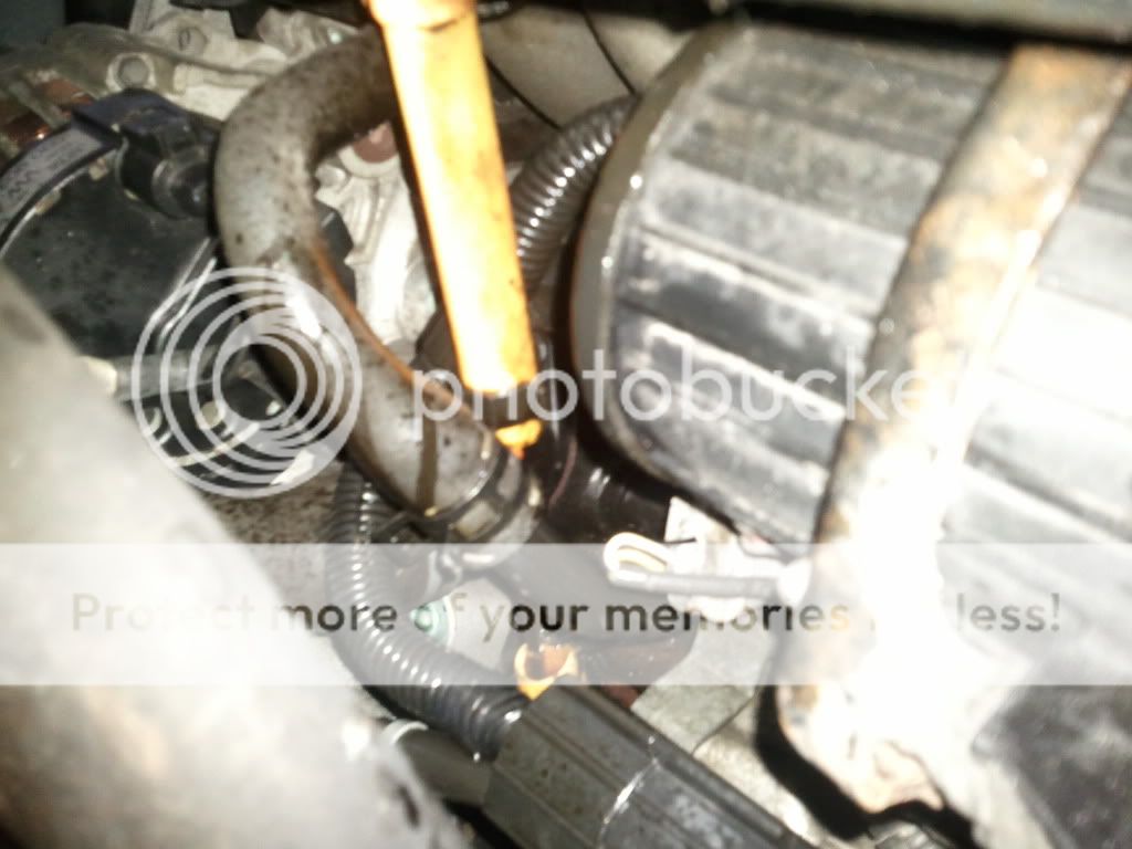

Ok, i managed to find the diagnostic port and turn EM light off, but notcied that oil is spitting onto the hoses from the engine, and realised theres a big peice of my dipstick case missing, how do i get a new one????? please see pics below
is this normal???

around £10 inc vat from vw , use a pair of molegrips and clamp around the broken peice that goes into the engine (be carefull not to over grip onto it) and and gently pull towards ya , take ya time cos if it snaps below the hole ur gonna be f**ked  :lipsrsealed: fairly easy tho tbf

Ok may be worth getting it there instead of waiting for one from ebay then. So you pull the part of the engine frst and then pull the bottom half out too ye? its snapped in the middle as you see from pic.

Just grab one from the dealers.

u prob have one by now but euro car parts sell them
