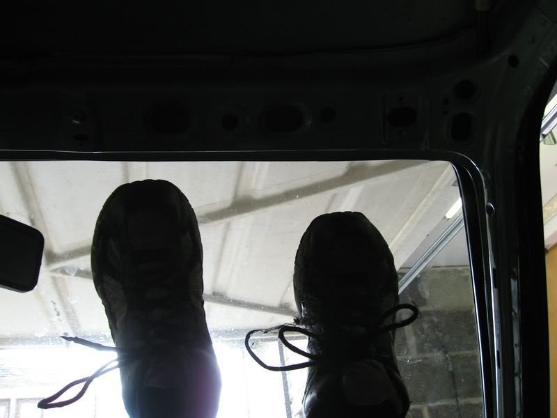

lay on your back and push carefully at the top of the screen, starting near the corner with your FEET. you can see the rubber slowly moving and you work your way along the top and the screen just lifts out !

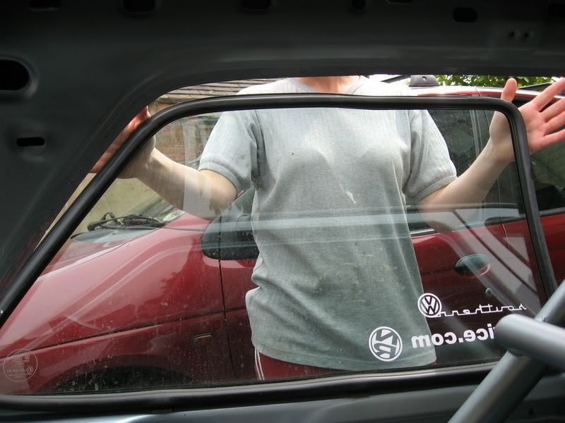

To remove the old window, simply press firmly on one corner and maintain the pressure,
you will SLOWLY see the rubber start to `unfurl` and loosen its hold on the glass
Maintaining pressure move your hand along the glass and allow the rubber to unfold at its own speen, DO NOT FORCE IT, it will take time.
When the top edge is complete, the screen will `fall out`, have the second person take the weight, allow the rubber to unfurl down the edges and lift out the glass
Lift the glass clear and place to one side

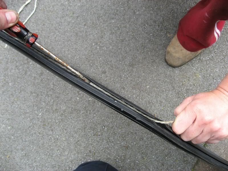

Using a length of STRONG twine, press it into the rubber, where the metal will eventually sit, I used a flat bladed screwdriver to push the string to the bottom and to aid fitting, dragging the screwdriver along pressed the string in much faster
Leave 12" lengths overlapping at one corner

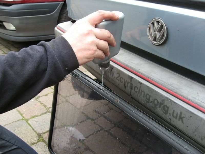

Using diluted washing up liquid / water mix, thoroughly lubricate the slot with the string and the inside rubber edge

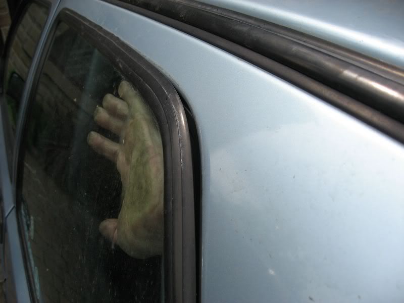

I`m not sure if this next bit is the correct way, but it seemed to work well for us. I put the bottom corner in place and made sure the rubber sat properly, inside and out

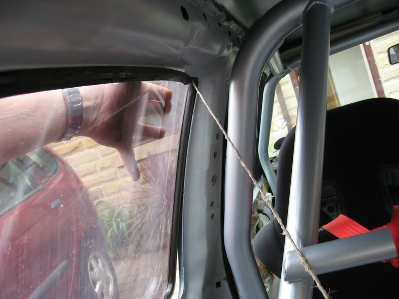

Next, whilst the person outside puts LIGHT pressure on the glass, the person inside pulls the string horizontally away from the glass. This is the bit where the string deforms the rubber and causes it to fit over the metal  :thumb:
Slowly work your way along the top edge of the glass
Continue along the top
Now, have a loow from the outside and check the rubber lines up with the marks on the paint from before, I needed to push the whole pane of glass slightly towards one side to make it `sit` properly in the groove, its obvious if not, the string becomes much harder to pull. Continue pulling the string. If you find it difficult, try pulling the other end and working from the opposite direction, by doing that I found it went in easily

I agree but would never use water on the seals, that will just help it rust!  White grease works very well.

Good guide, but a couple of points, I would never push out a healthy windscreen with my feet, fair enough if you're going to fit a new screen, but putting all the force on a good screen is pointless, and will end in tears! :smiley:
2nd point, lubricate rubber seals with French chalk, this will remain on the touching surfaces of the rubber and body, and will eliminate squeaking with any body flex...

When I used my feet, it was the flat of my soles, to try and spread the load. Using your hands would be more of a point loading than your soles of your feet wouldn`t it ? Maybe I`ve been lucky, I`ve removed / fitted several since I wrote this and never had a problem. Using the screwdriver is a more controlled method though. Good point.
I wouldn`t use soapy water if there was any rust, I`d obviously treat that once the glass was removed. Does french chalk allow the rubber to slide over the seam easily enough ? I hadn`t though of that either  :grin:

Whether its your hands or feet doesn't really matter, its the fact that you are putting the glass under pressure, any chip, or nick in the glass is a week spot, carefully feeding the rubber out with a screwdriver will not put the glass under any strain...
And yes, the french chalk works really well, evidence of FC should be evident on the rubber seals that was put the when the car was built... like a white waxy chalk residue. Also 4mm Para/curtain cord is perfect for pulling in the glass, as it will not tear the seal
