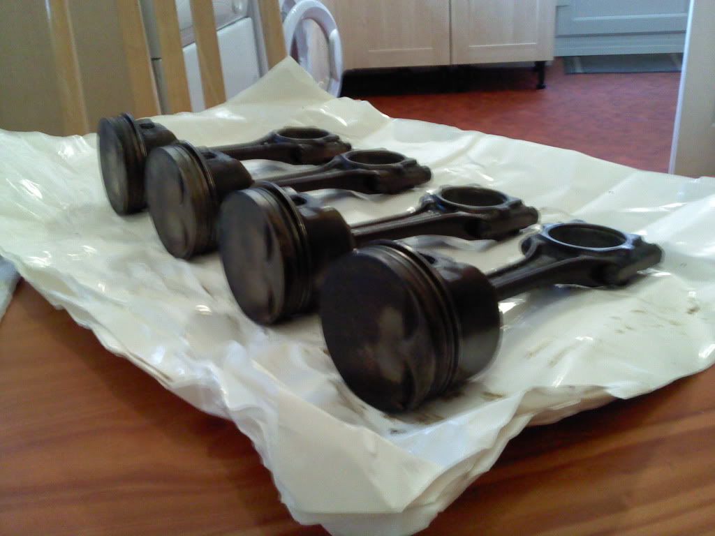

so that i get clearance for my many valves i've baught a set of second hand abf pistons from a mk3 valver
as you can see there caked up with crap so thaught best to clean em up and check everything fine so...

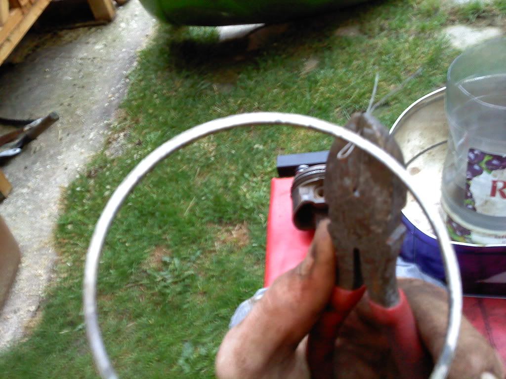

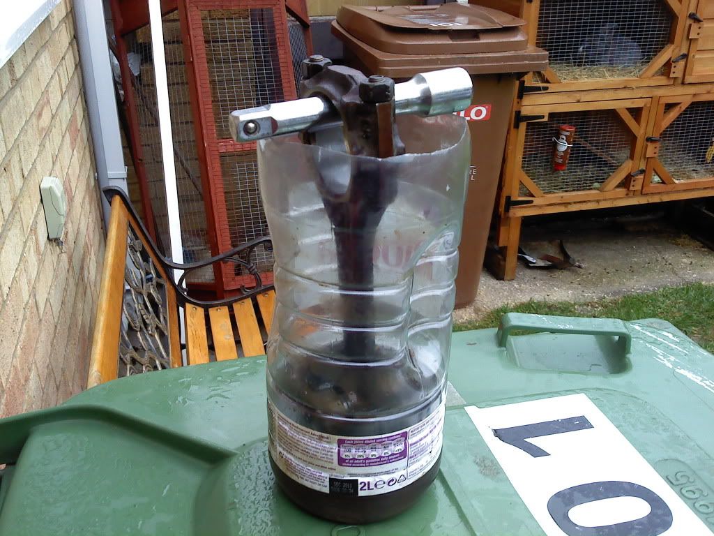

also noticed all oil holes in the oil scraper rings were blocked so came up with an idea that did the trick
and all cleaned up and back together..

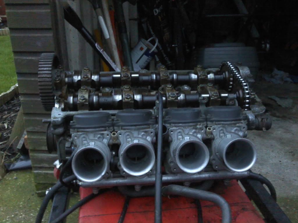

then came the delivery of what i'm using to fuel the engine with. in the form of some yamaha R1 carburettor awsomeness!!!
and they'll be getting stripped down cleaned up and jetted accordingly

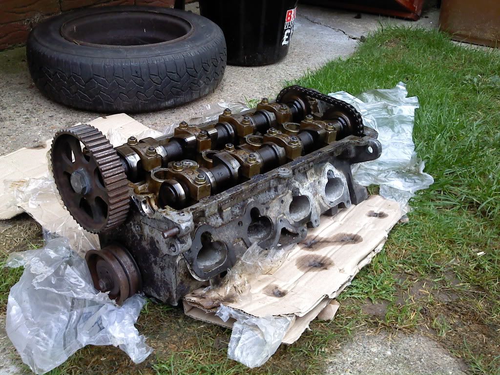

and a few days later came some more powerfull awsomeness being a mk2 gti 16v cylinder head  :D
and some pics with the carbs infront of it cuz i can really
and soon set to dis assembling the valver head to clean it up get it skimmed and re-seat all the valves .....
the head nerli stripped ...
3 out of 4 valves lapped and re-seated on cylinder 4
a before and sfter shot
and the bits i can do on the head are nerli done now then its getting sent off for a skim.

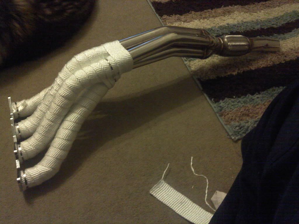

and today came a parcel  :D  in the form of a 4 branch stainless steel exhaust manifold
and i then broke out the heat wrap and wrapped the manifold up nice before running out  :x
then after heat wrapping i realised it was a bad idea as the manifold will most probably need modifying as i've had to buy a mk2 golf 16v mani to fit the engine as they dont make them for the 16v scirocco as there so damn rare so the mani will prob need to be modified to fit with the 2 litre block being taller than my 1.8 aswell as havving an anti roll bar in the way or the zaust...

Might be worth checking, but will a 1.8 16v head fit and work on 2.0 8v bottom end.  :undecided:
not if i used the 2.0 8v pistons as they woul the valves but thats why i baught the abf pistons from the mk3 16v so put the 16v pistons and rods in the 2.0 8v block then all will be fine
