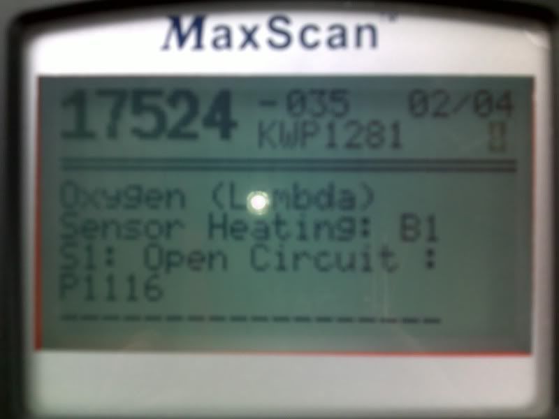

Here's my fault codes
« on: 31 March 2011, 12:23 »
What do they mean?

You got a fault lambda sensor front for fuel B1 S1 get a new one fitted.
Then B1 S2 is due to having a decat fitted to the car.

Cheers Nick, I'll get a new sensor as soon as.
So far as I know I have a cat.
Ps, the one that says check DV, I've since fitted a Forge 007p. Not sure if I'm imagining things, but it seems to take off better, but still may be worth me getting boost checked for correct boost and leaks.

Having reset the codes, I went back out to get the front lambda sensor and codes P1116 and P1103 came back, the other two haven't.

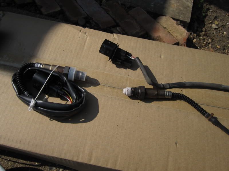

Replaced my lambda sensor this morning.
Was surprised at how easy it came out, after a good soaking with WD40
