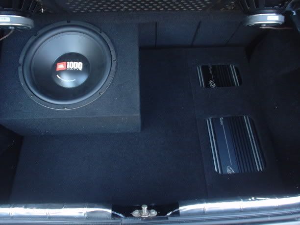

i'd made some half assed attempts at installing my amps/sub etc. at first it was going quite well but i have to admit i'm sh!te at wood work and so kind built everything off the top of my head as i went along. in  hindsight i'd have planned it all a bit better!!
basiclly all i wanted was to keep as much of my boot space as possible, have easy acess to the spare wheel etc, and for it to look neat.
first attempt looked something like this:
doesn't look too bad but in reality it was a bit sh!te and messy. i also bodged the rear carpet by being tight and not wanting to pay for proper carpet. so used the original stuff. it kinda worked out ok but i wasn't happy with it. the biggest problem was that i was running a pretty basic headunit with only one pre out so was splitting it between the two amps which was less than desirable!!

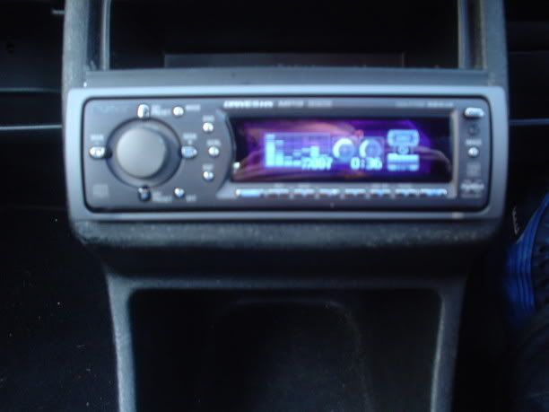

so after hunting around i bought a new headunit for a bargain price. i listened to alot of opinions about which h/u to buy but at the end of the day i like sony's and have never had problems with them so decided to stick with another. plus the blue display matches all the other blue bits. it also has the all important 2x preouts and 1x sub out allowing it to set up the install nicely. so i stuck that in, tweaked the amp rack so they sit below the false floor and got some proper carpet. took me a while to get it all sounding as i liked but i'm very happy with it. the stereo also comes with a remote control which was very handy when it came to setting the amps (in the boot) while adjusting the headunit (in the front, obviously!)
the flase floor is split in two so you can gain quick access to the amps or the spare wheel.
headunit:
new improved install:

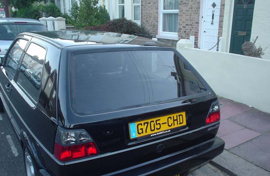

was getting tetchy about the weather being sh!te which meant i couldn't fit my new tailgate etc so i went to a scrappy and got hold of some glass off a basic model golf so i can do with out the rear spoiler. i was planning on fitting it at the weekend then had the bright idea that at some point i want my windows tinted, so i made a quick phone call. i knew i was working up near gatwick on the monday so arranged for keiran at gatwick autoshadesto tint the rear window before i put it in, he did a top notch job and would reccomend him to anyone. so i spent monday night swearing and sweating trying to get the frickin window in!!
but its all in and looking sweet! i really want to stick some pics up to show it off but can't seem to get a decent shot of it while its indoors. the only other thing i had a problem with was where i'd had the rear plinth smoothed over the original number plate lights wouldn't fit so i bought some water proof LED blocks from ultraleds.com, they arrived this morning and i wired them up quickly and man are they bright!! they fit nicely too so will break out the sikaflex to gte them in there nicely and make sure they seal up any gaps as mk2's are notorious for spray up the tailgate which only leads to rot!

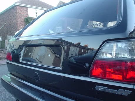

well even though i've been showing off about it on the other sections i thought i'd better update this.

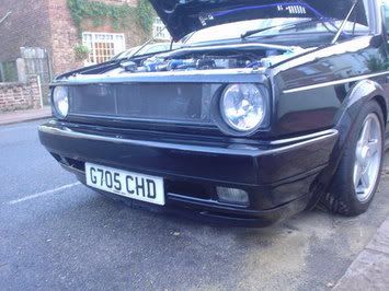

i got home nice and early the other week and fitted up my new tailgate. really happy with it and its transformed the car. the guy who did the paint job did a great job and he buffed the paint back amazingly. with the matching bumper also on it completes things from the rear. the LED's i installed worked out really well and cast a very nice white light.

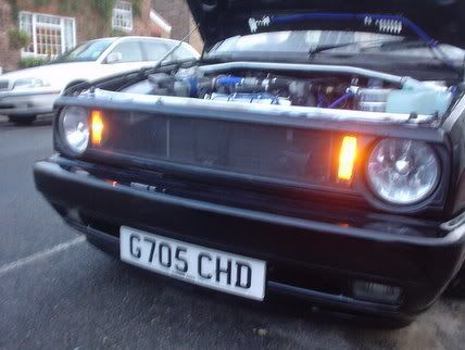

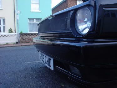

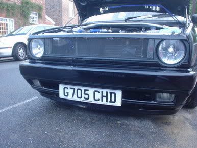

then at the weekend i got a call from my painter guy saying the front bumper was done as well so he bought that round and i've just fitted it:
having had everything smoothed off on the front bumper i had to relocate my indicators somewhere. i was going to stick them in the fogs but decided to do something a bit different. so i went to german and swedish and bought some small bumper smoked indicators as the big ones were too big and mounted them vertically in the grill. as i have that mesh grill they shine through no problem and although they aren't installed the neatest at the moment, they work well and more importantly, they are not obvious! i might have to take them off and spray the casing matt black just to make sure they stay hidden away and am probably going to make another grill with the indicators in mind. the thing is you have to screw them in from the front otherwise it makes changing bulbs etc a complete nightmare. a bit of headscratching and clever welding should make a neater job of it but for the time being they look and work fine.

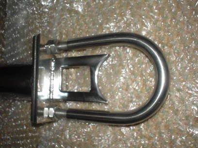

first of new parts turned up today!
nice new rear strut brace! was nice and shiney and i was a happy chappy alright! took a few minute to fit and looks cool. my sub box is a bit tall and wont fit under it so it looks like my plans for a stealth style sub box might have to come quicker!

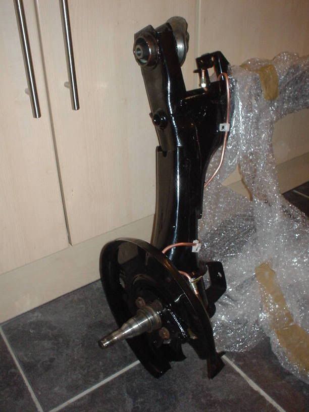

right well i've been getting on with quite a bit but none of its finished so didn't see the point in updating this!! first i've split my BBS and have bought new, wider rims. the centres are being coated at this moment in an as yet undisclosed colour ;) as i want to keep them a bit of a surprise! the anthracite i had before was wicked but i've seen quite a few people with them like that now so as i was splitting them for the new rims i thought i'd have a change! as far as i know no-one has done this on a set of rs yet so should be cool!

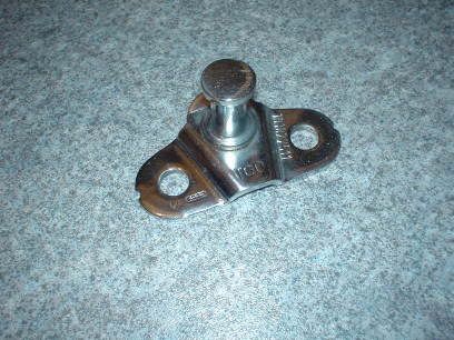

i also switched on ebay one saturday mornign and saw this:
was only 99p so i bought it! was one of those little bits i'd never got round to doing on my car so was an easy fix! doesn't look amazingly bling in the photo but what can i say? its a chrome boot catch!
i have also made a good start on my interior but again can't see the point in showing too many work in progress pics but if it turns out as good as it started i'll be a happy chappy!

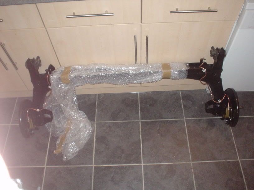

lastly i picked up a spare rear beam as i didn't think my rear bushes and bearings would survive the next MOT, so figured i'd build one up off the car and swap them over. i had the beam blasted and powder coated and it came back better than i expected, alot smoother and shiney! then tonight i built it up with new rear brake lines and bushes and am waiting for new rear bearings and discs to arrive so i can bolt them up then just do a swap with the crusty one thats currently on my car. i might re-paint the calipers while i'm at it as i'm a bit bored of the blue!
beam looks nice though!!
