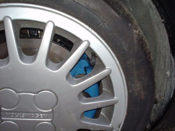

also i noticed that after a while of not driving my brakes had turned a nice shade of orange!! so i took them off, cleaned up the disc (easier than i thought it would be!) and painted the calipers. i had painted them black before to keep with the subtle look but i also thought this was a bit boring. so decided as my engine will be detailed with little bits of blue, and a certain brand of silicone hoses will go on eventually, that i'd paint them blue. they looked alright although i didn't do the best job, wasn't in the mood really but they look better than before. while the brakes were off i cleaned up the hubs etc and gave them a lick of paint too. also noticed that the coils of my springs are almost an identical colour to my fresh calipers! result!
here they are peeking out from behind my sh!tty winter sebrings

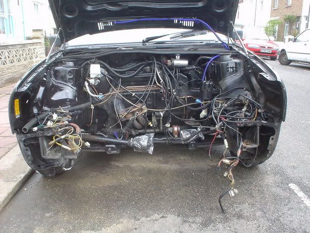

i love the fact that you can take the whole front off golfs with a few bolts! makes life so much easier so once i'd got the gearbox mount lined up i bolted up the front crossmember with the front mount in place then dropped the engine onto the rear mount.
from then on it was a case of plugging wires in and plumbing hoses in. while i was at it i decided to put my new chrome slam panel on and built as much as i could. all that was left to do was put the radiator in (when it arrives) and bolt up the drive shafts, put the pulley on, time it up and then fit the alternator. the only reason i haven't fitted it yet is because i'm intending on polishing it up.
some pics of my engine in place:
