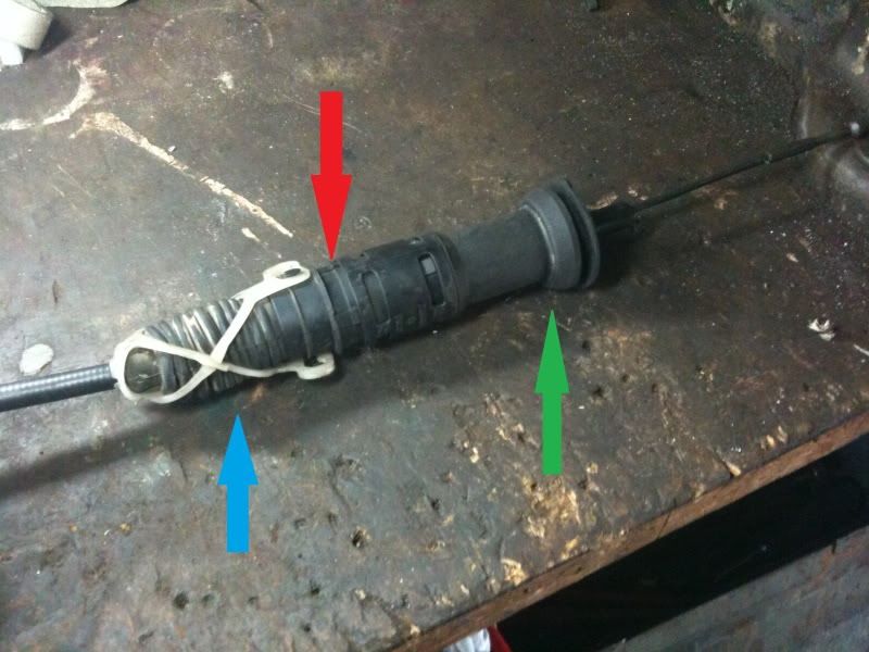

So I am calling the blue arrow the spring end and the green arrow the cup end, just to make things easy.
The red arrow on the first pic shows where to separate the adjuster.
You want to take your screwdriver and work the it around the clips to release them. You can twist the sleeve (the bit in-between the spring end and cup end) to cover the clips, but you will need to loosen it off first.
Pull the two half’s apart and you are left with this:
Then pull the spring end down towards the long end of the cable, whilst holding the cup end. Be careful not to pull the cable thorough the rubber at the cup end.  Push the cup end over to one side to lock it onto the white barrel. Use the screwdriver to secure it.

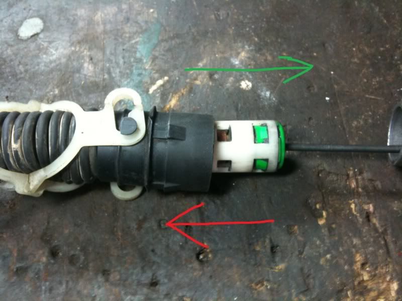

Now carefully remove the screwdriver and allow the white barrel to come back inside the spring cup. If you look through the holes in it you will see a copper part and a lead part. You need to slide the lead part up to the copper by sliding the white barrel as far to the spring end as it will go. This is shown by the red arrow.
BE VERY CAREFUL! The ball bearings can fall out and then it is a total pain the arse. Do this slowly and gently with a bit of added grease to the balls so they don’t fall out.
Once you have done this return the white barrel to the ‘locked position on the spring end, with the screwdriver hold it, as you did before. Follow the green arrow.
Make sure you have all your balls in the white barrel. There should be 12.
Now take the cup end and remove the silver sleeve from it. You may need a small pair of pliers if it is greasy.  Slide it up the white barrel, as indicated by the red arrow.
