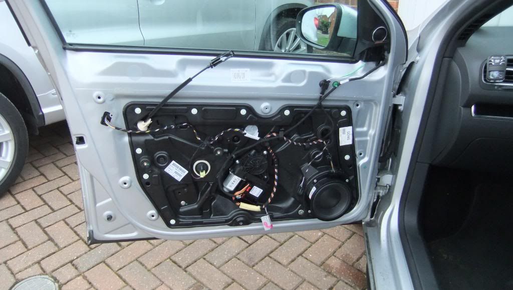

Offline Jimble
  • Posts: 4,657
you've most likely already seen this pic snoops from SteveP "how to" but it may shed some light on what could be the cause behind the door card, looks like there is only one clip at the top but do you think those round sticky back things are spacers? maybe yours are missing?
Offline Snoopy
  • Moderator
  • Posts: 7,801
  • Geoff.
I don't know  :undecided:
I wonder whats stopping that middle bit from moving towards the window on my rear drivers door but not on the other 3 doors :undecided:
Something must do. I thought it must hang on a U on that edge were the window is, were the rubber is on Steves Photo like old door panels designes use to but i guess not. :undecided:

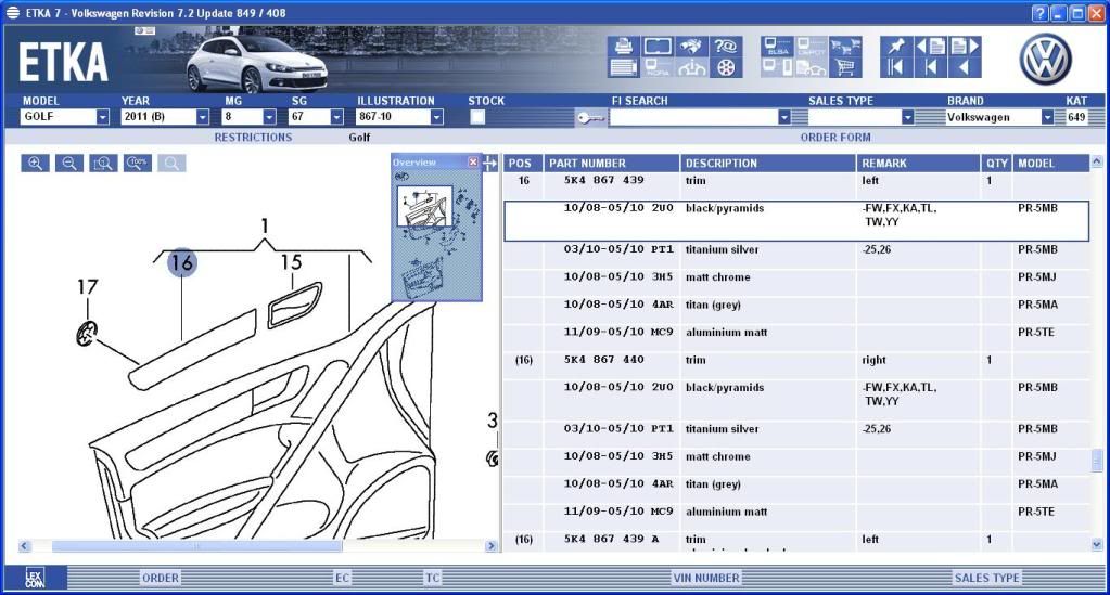

Offline SteveP
  • Posts: 2,041
ETKA lists the trim pieces and a clamping washer (part 17 below) as separate items.
It also mentions a parts bulletin ref 8-179 but I don't have access to this.
