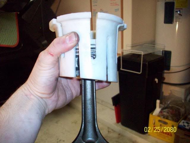

Very good work, are you aware you need a specific ring compressor. I know its not needed yet but dont want to find out on the day that your standard compressor wont do the job  :angry: .... yes i got a wee bit annoyed that day  :grin:

hmmm i didnt but thinking about it,is that because the bores are 15deg to the face of the deck?
cheers for the heads up. :evil:

Precisely, a standard compresoor leaves a gap at the back letting the rings pop loose.
I HAD to have my engine up and running the weekend i did mine and tried alsorts of ways... even using fingers to get 1 piston in  :grin: :lipsrsealed: It hurt lol... ended up buying a new set of mahle rings coz i broke so many  :grin:
Basically you need one of these:
Thankfully a good mate at awesome gti sorted me out and borrowed me one, I read mixed views on them but the pistons flew in.... just make sure its lubricated  :smiley:
