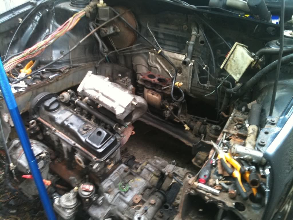

Well made even more progress from earlier
I managed to remove the fiddly brake servo so that will be painted in the coming weeks.. also removed all the loom from the engine bay just got to wort the interior bit and that can be sent off to RubJonny..
Well anyway here are some pics for anyone if they interested..
The fiddly clip holding brake pedal to servo for other peoples referance
The space it left behind
My collection of breaker bars inc the daddy snap-on ratchet bar that shifted the hub nut !!
All the loom from the bay !
Always been told to organise all nuts and bolts for future referance so i did
How it looked at end of the day
Thanks for looking more updates to come sooon
