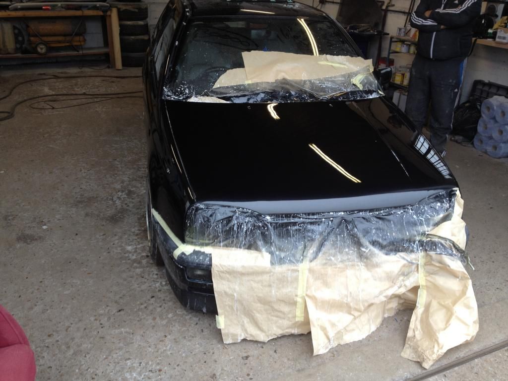

I had some paintwork redone by the place i originally got in done by, as I wasn't too happy with some bits.
Much happier with the result.

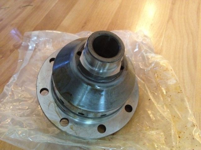

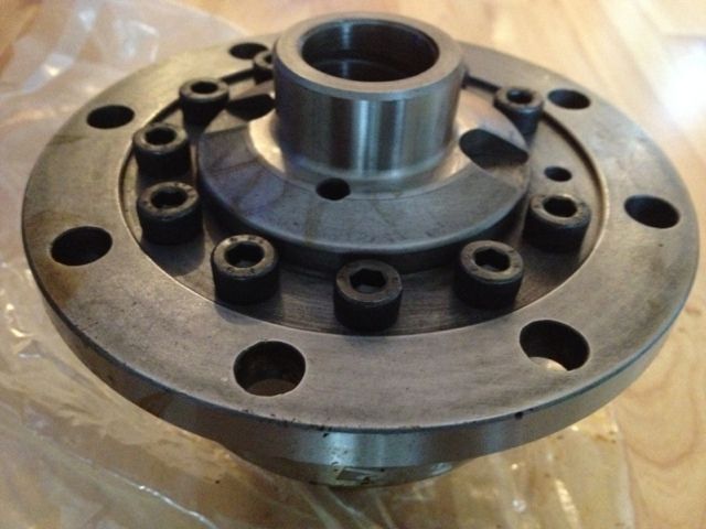

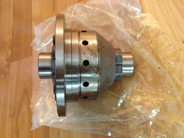

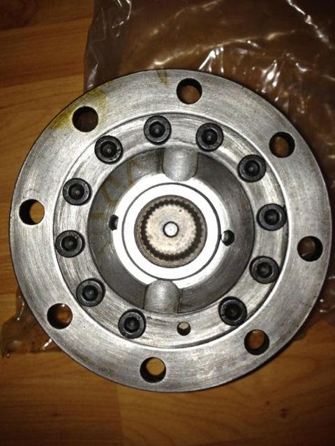

Also in the search for more traction, an OBX 02J diff was sourced ready to fit into my spare 16v box together with a VR final drive.
Quality seems good. Need a few more bearings and synchro's to buy, then get it sent up to Hotgolf for the build. Apparently they are the same as a quaife once sorted at just over half the price. They do need some machining to allow it to fit into the box and some new washers.  :cool:
