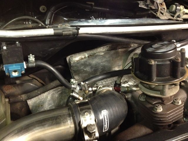

I wanted a neat install so had a good think about the best location and ideally didn't want to drill holes and make brackets.

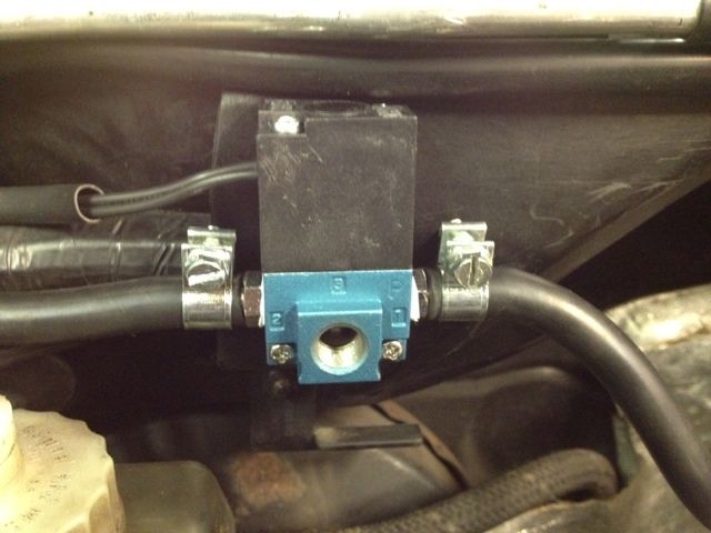

Settled on fitting solenoid on to scuttle trunking.
The position of the solenoid made plumbing to turbo and wastegate easier.

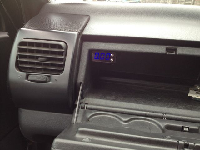

A bit more head scratching, some removal of minimal trim panels and a location for the controller was chosen. Had to drill a couple of holes in the glovebox for wires and vac hose.
Went out to program some boost settings and it's very easy to use. Just need to do some datalogs so i can set ramp rate for boost. The boost seems to hold on better at the top end too.
