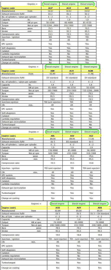

hi guys what codes are there for the 130's and did the 115 engines have a 6 speed box cheers

Here are the diesel codes from the Golf range

thank you kind sir
