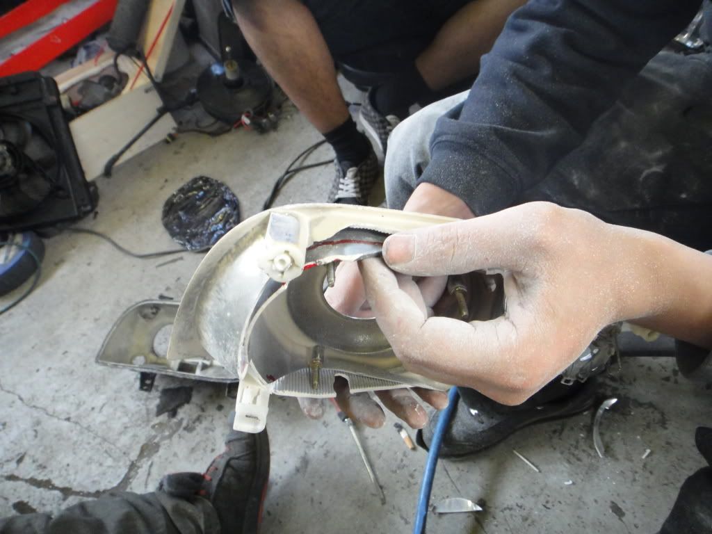

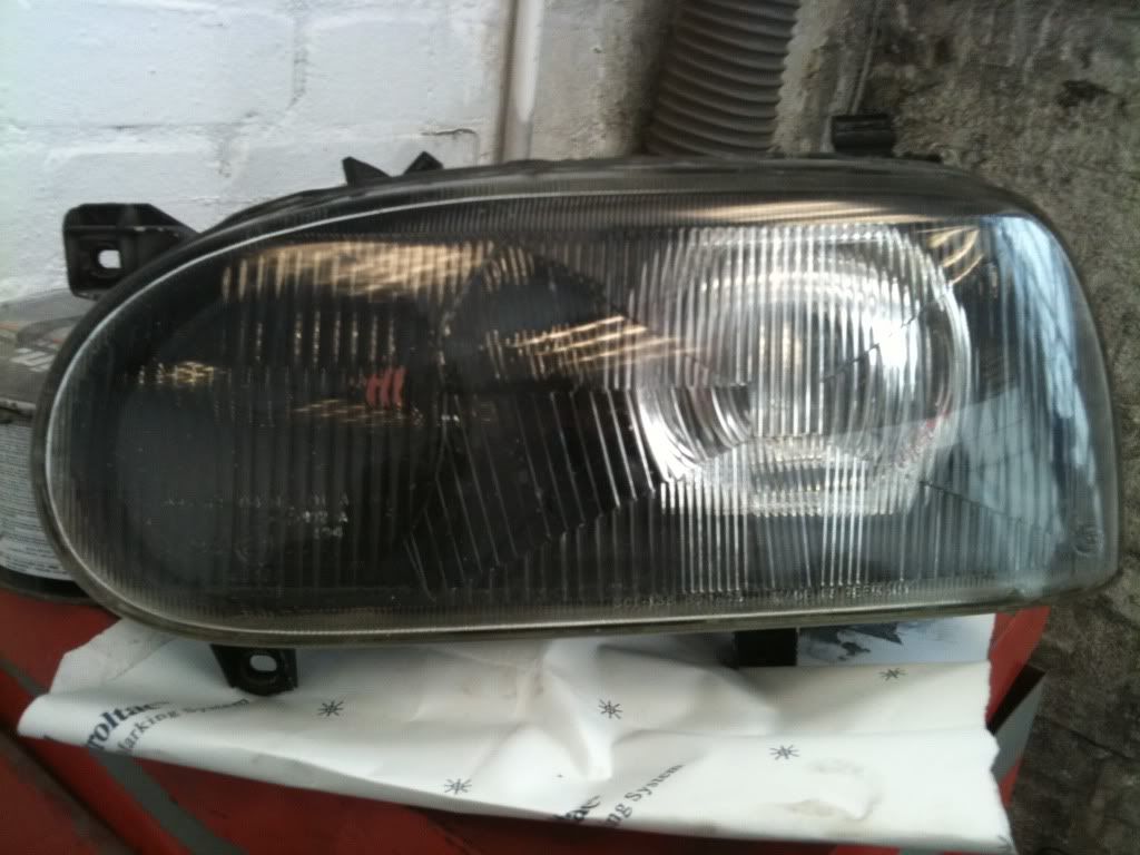

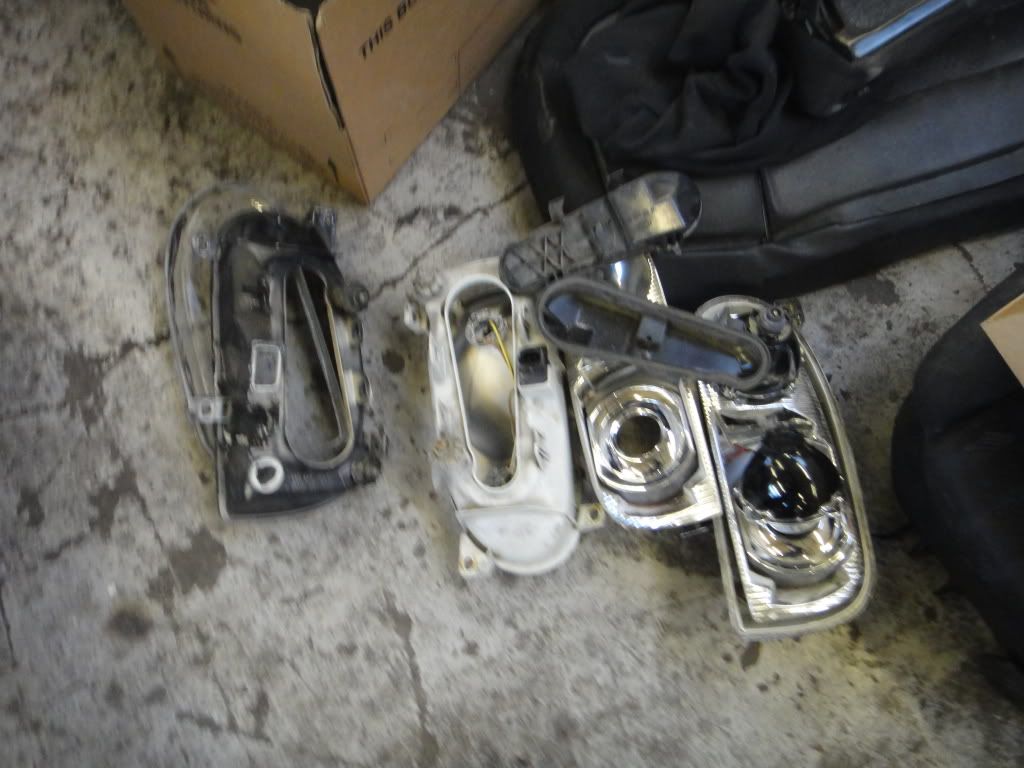

Mk3 & S3 head lights stripped apart

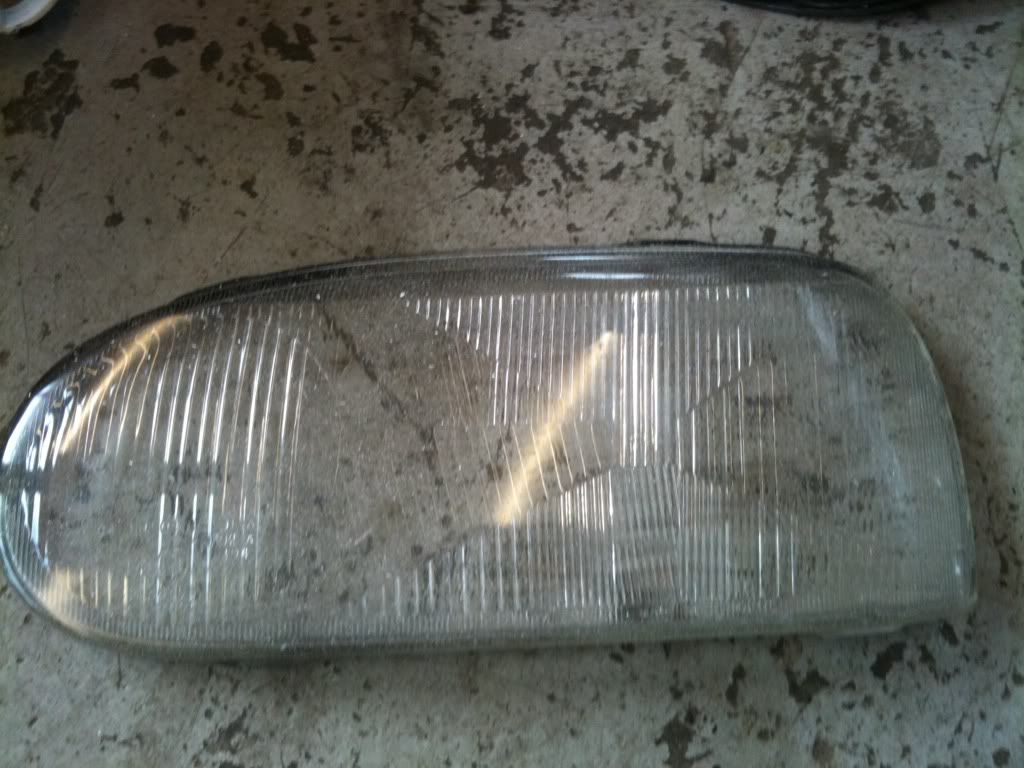

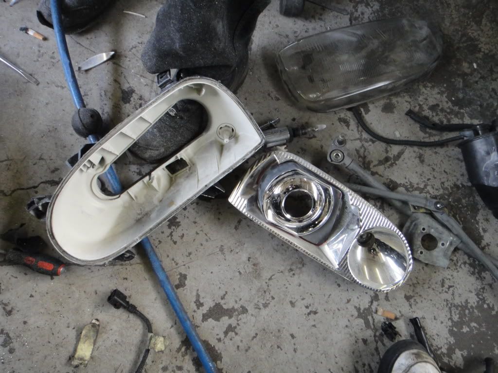

Mk3 glass
S3 head light casing

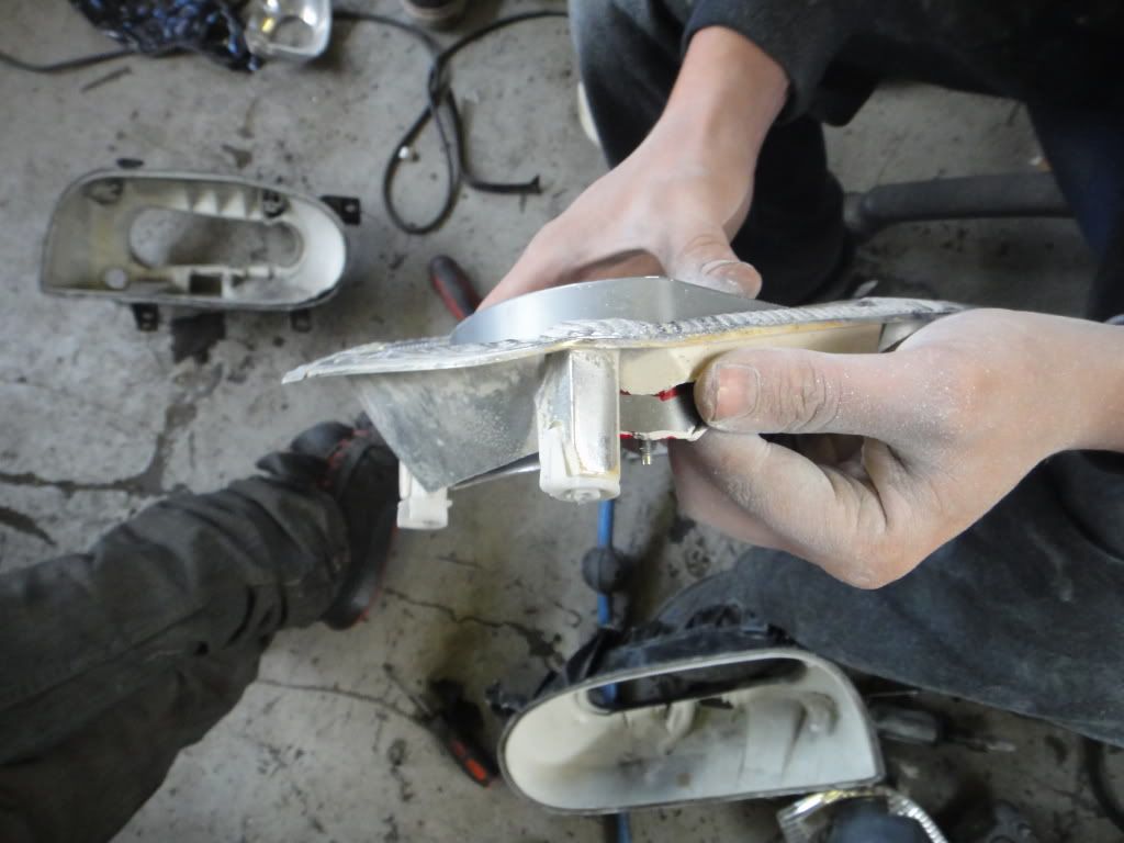

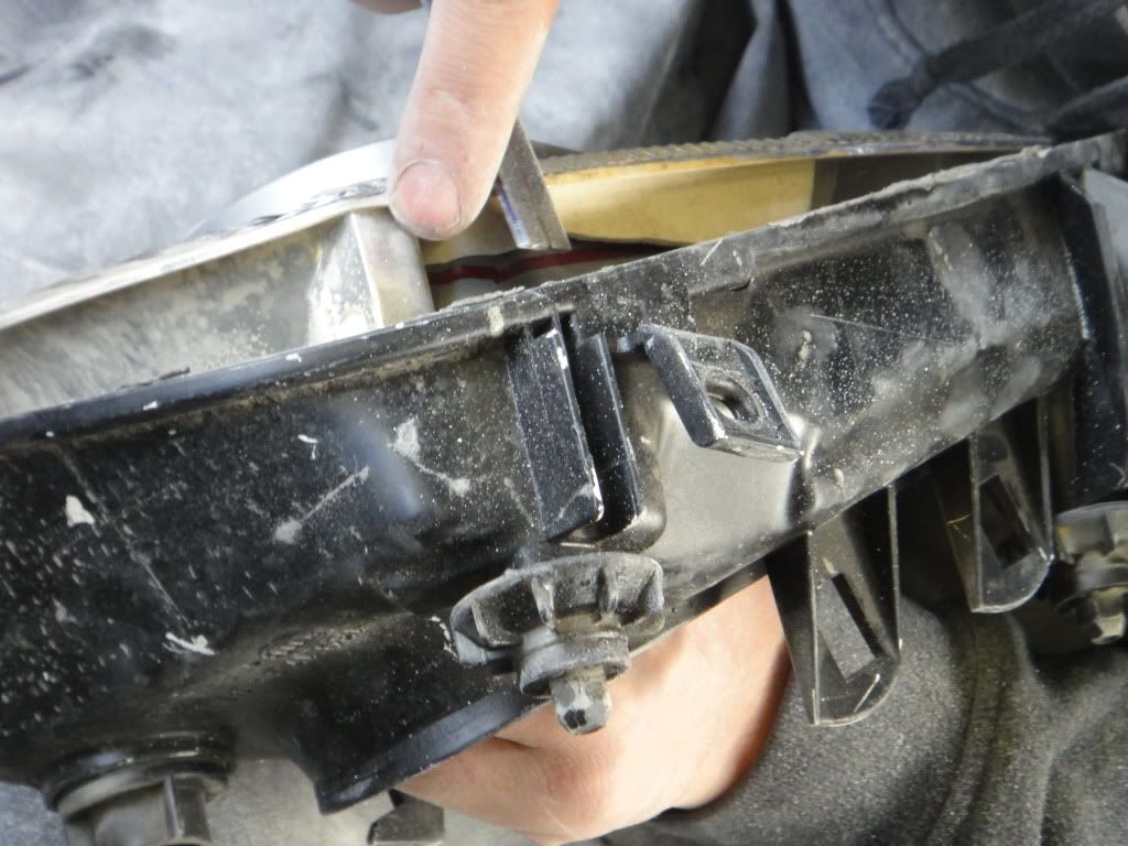

As we found out whilst stripping one of the light was that the adjuster brackets where broken so I had a few spare lights lying around so these where stripped for the brackets & a few other lights were stripped to make these 2 headlight good.
Mk3 headlight casing
S3 oem HID ballast with d2s bulb connection

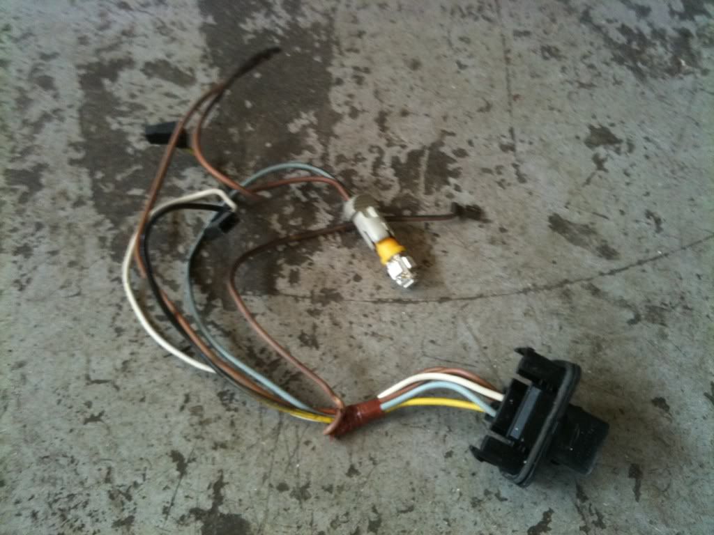

Mk3 head light loom, this is the one that is in side. We will not be using this any more.
Sorry I haven't got a pic of the S3 loom that we will be using & the black plug fits in the back of mk3 headlight casing

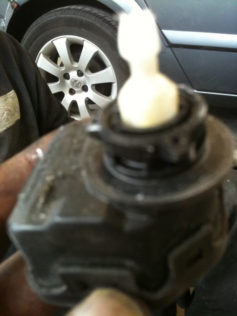

The Mk3 headlights did not have head light adjustment but the S3 ones do & as we have all the looms in place for this we thought it would be a good idea to make the headlights adjust with the motors oem style.
This is the mk3's headlight retainer which holds the inside of the headlight steady, this is also in just the right place where the motor needs to go.
This is the S3 one, sorry bad pic

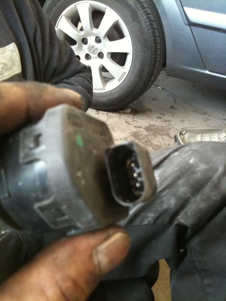

Motor connection.

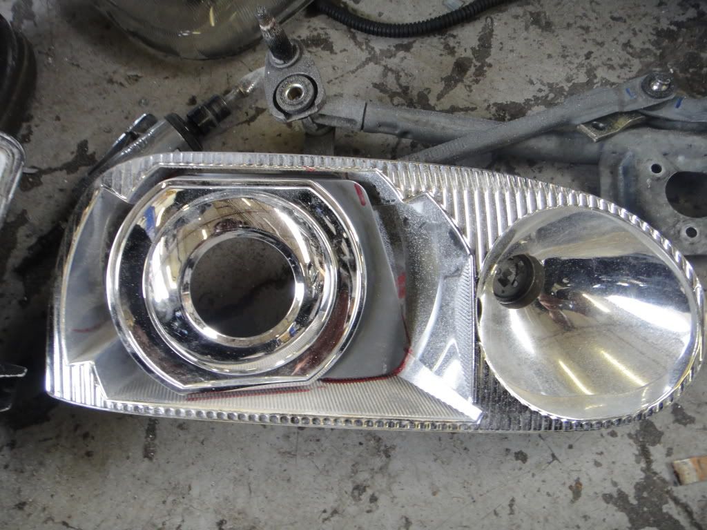

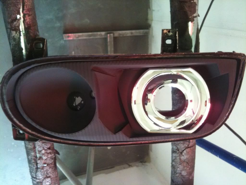

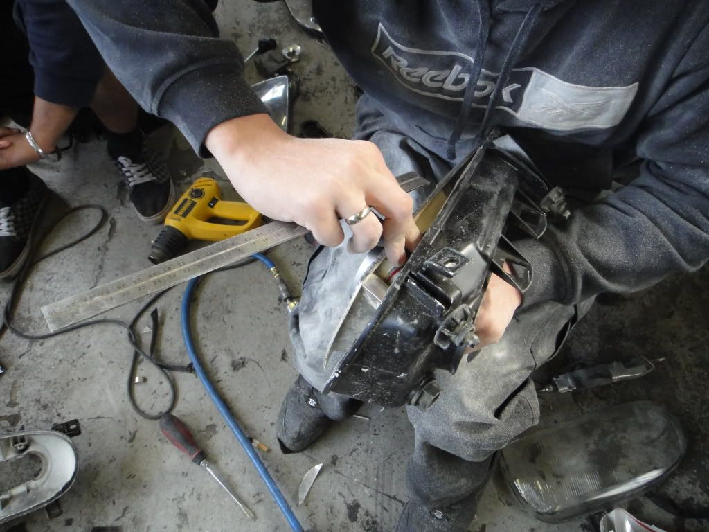

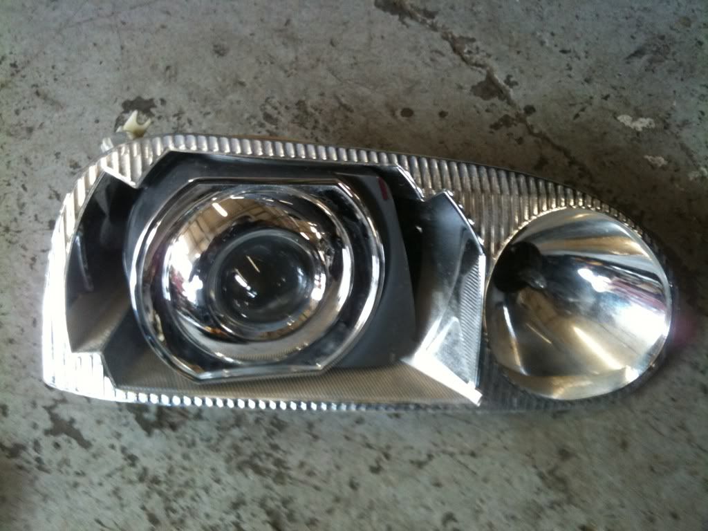

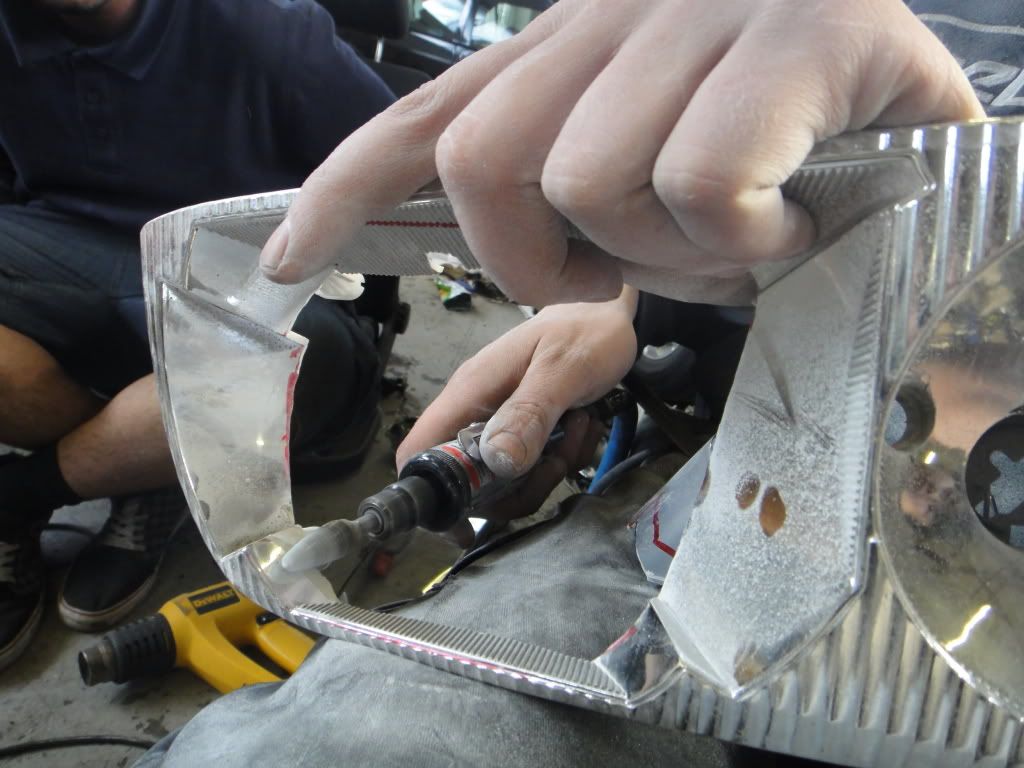

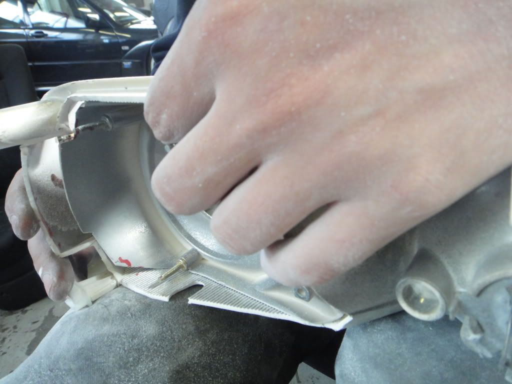

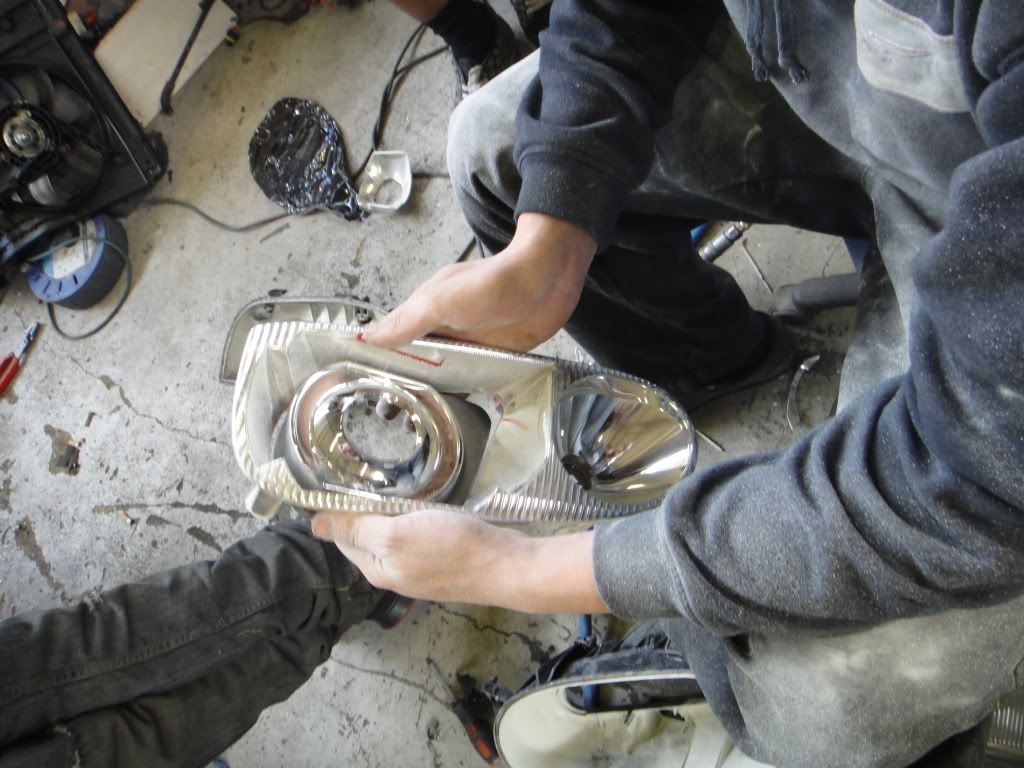

Now to take it to another level, the inside of the S3 head light was cut in half & we kept the project part & then the Mk3 headlight was cut to accommodate the newer projector & front fascia casing.
Hole cut & being trimmed to perfection

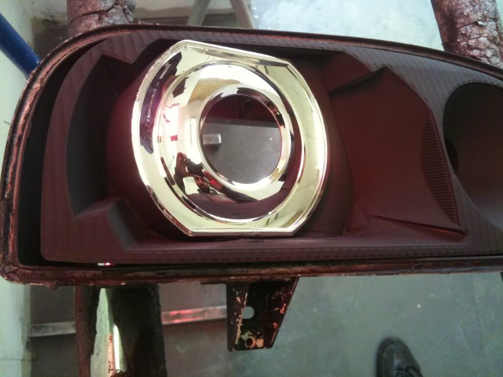

Projector casing & holder going in.
Now mounted inside the headlight
Keeping with the murdered look we had to paint the inside of the headlights & we wanted it a matt kind of a finish so we used some special we high temp paint that gave us a ultimate finish.
Subtle but the there

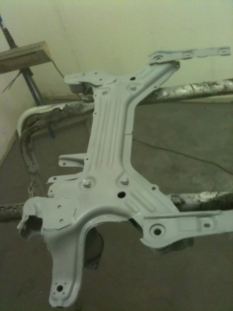

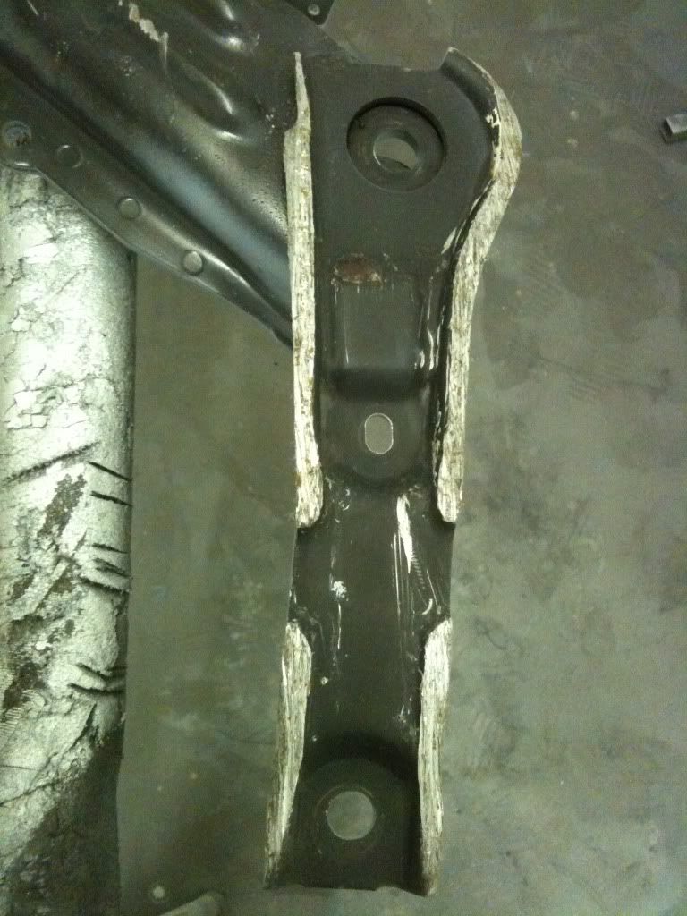

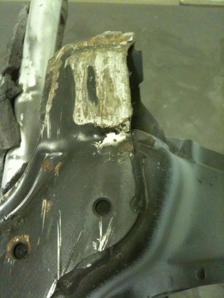

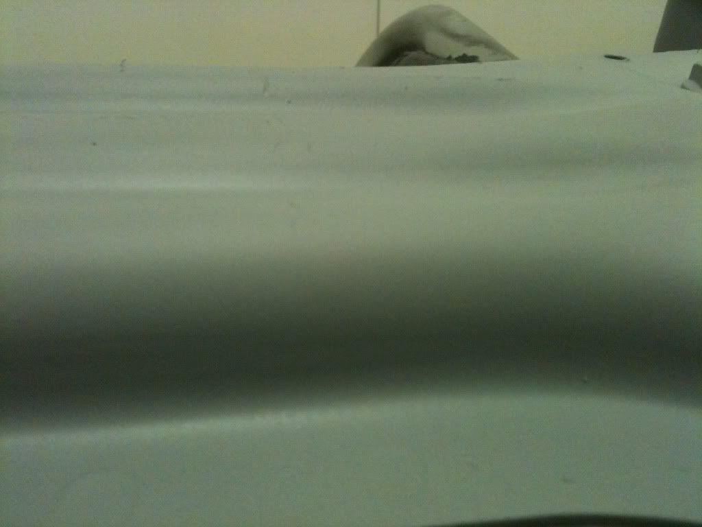

Next up was some subframe, steering & suspension work

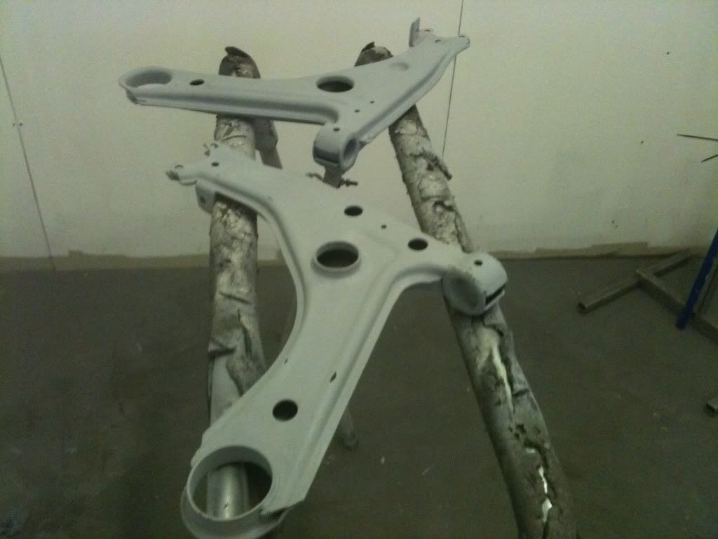

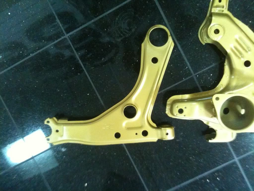

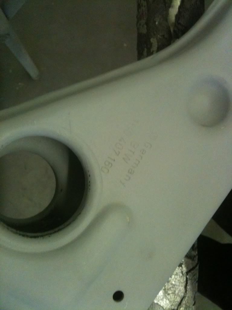

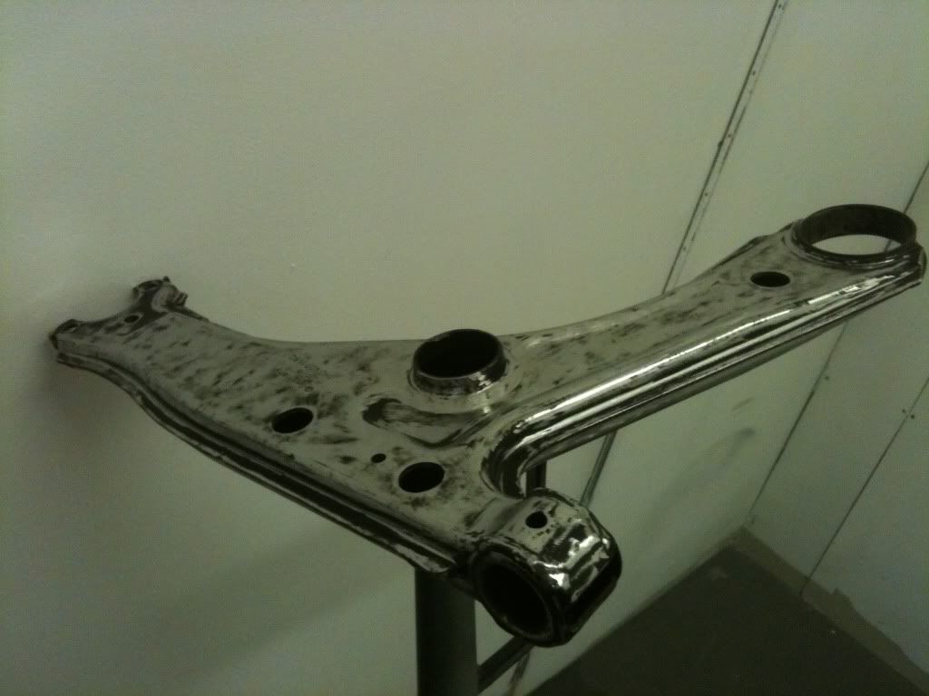

Wishbones all cleaned & ready for primmer
Now flatted ready to paint

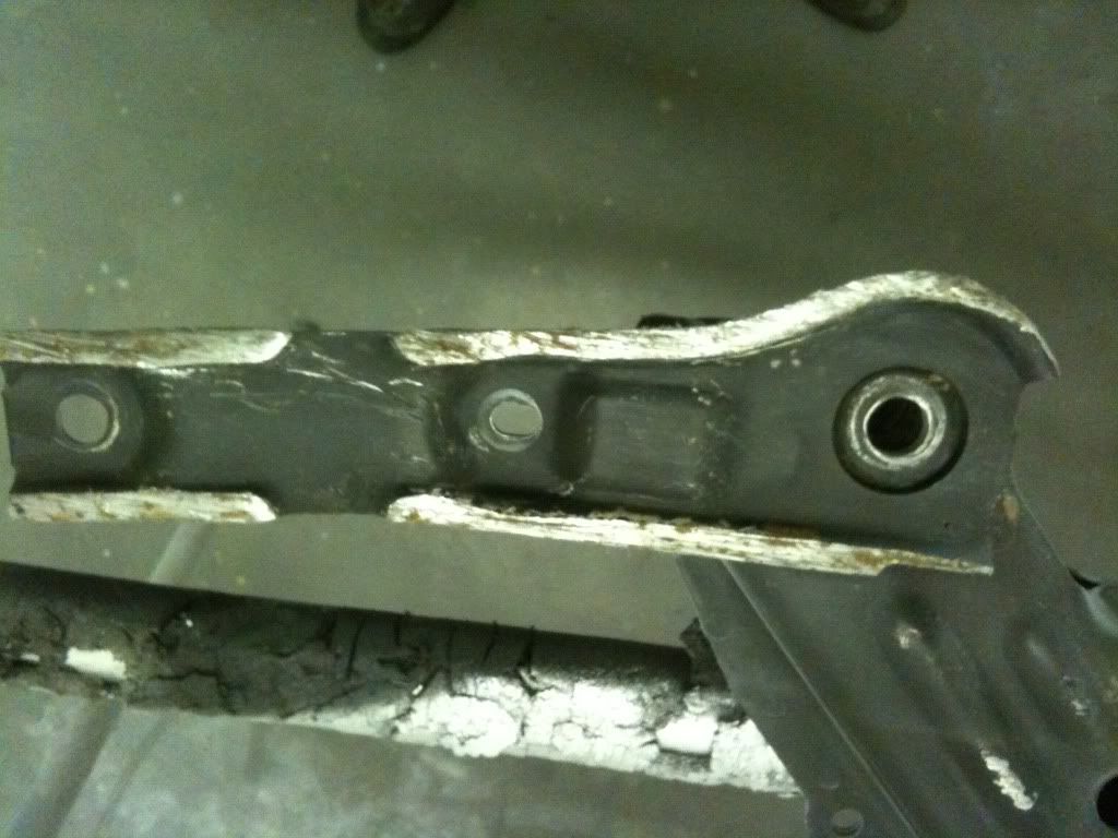

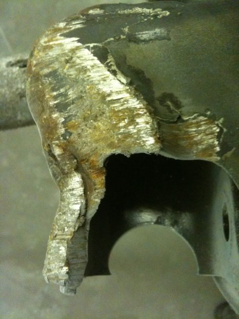

A few love bites from the tarmac

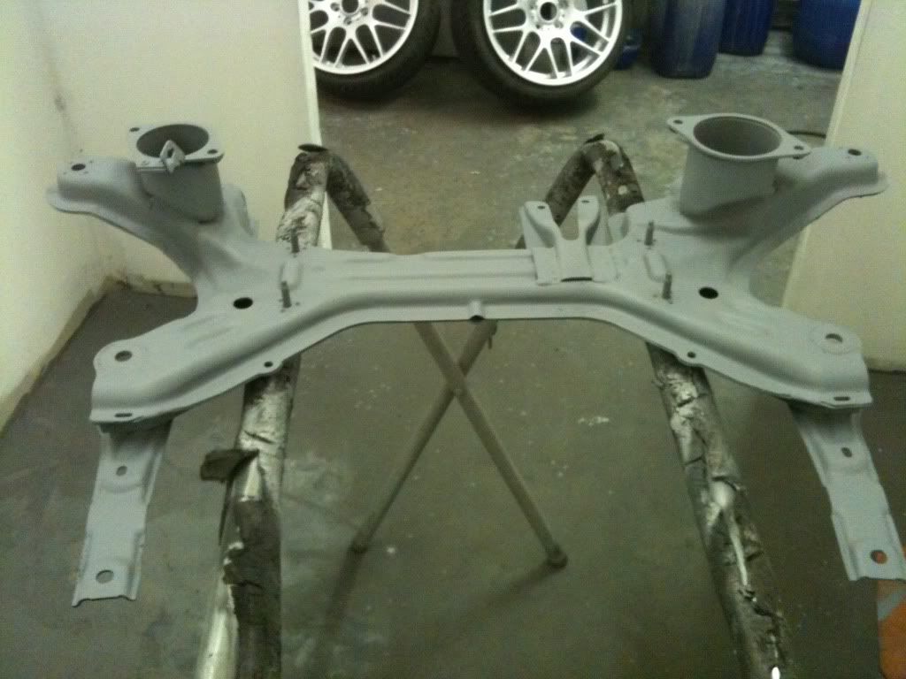

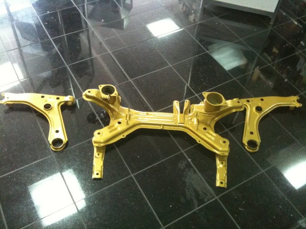

Subframe cleaned & primed
But I know all this will be kissed again

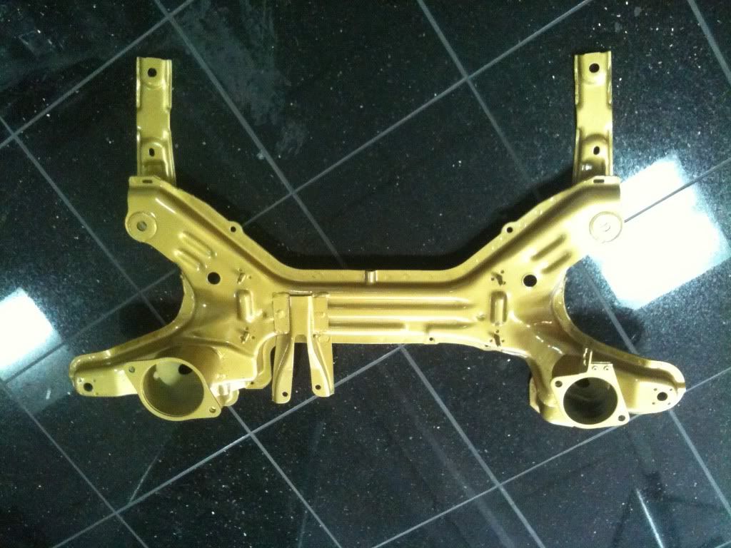

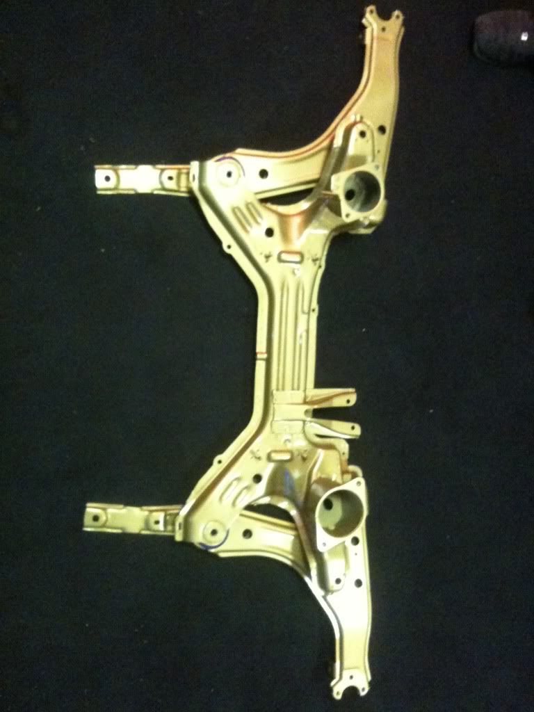

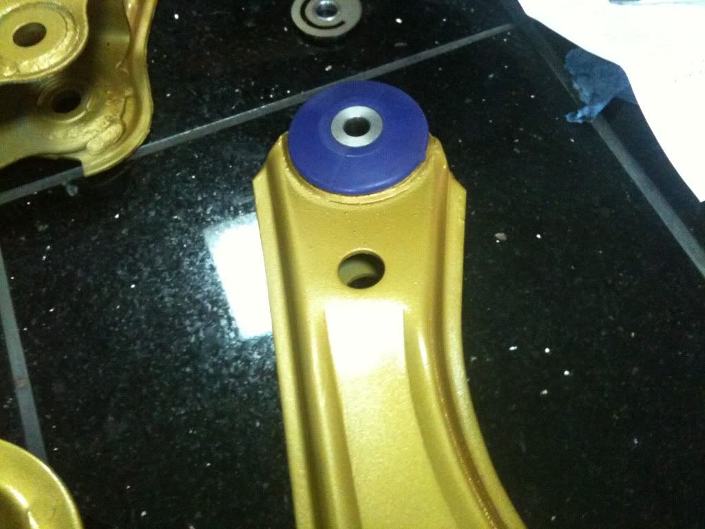

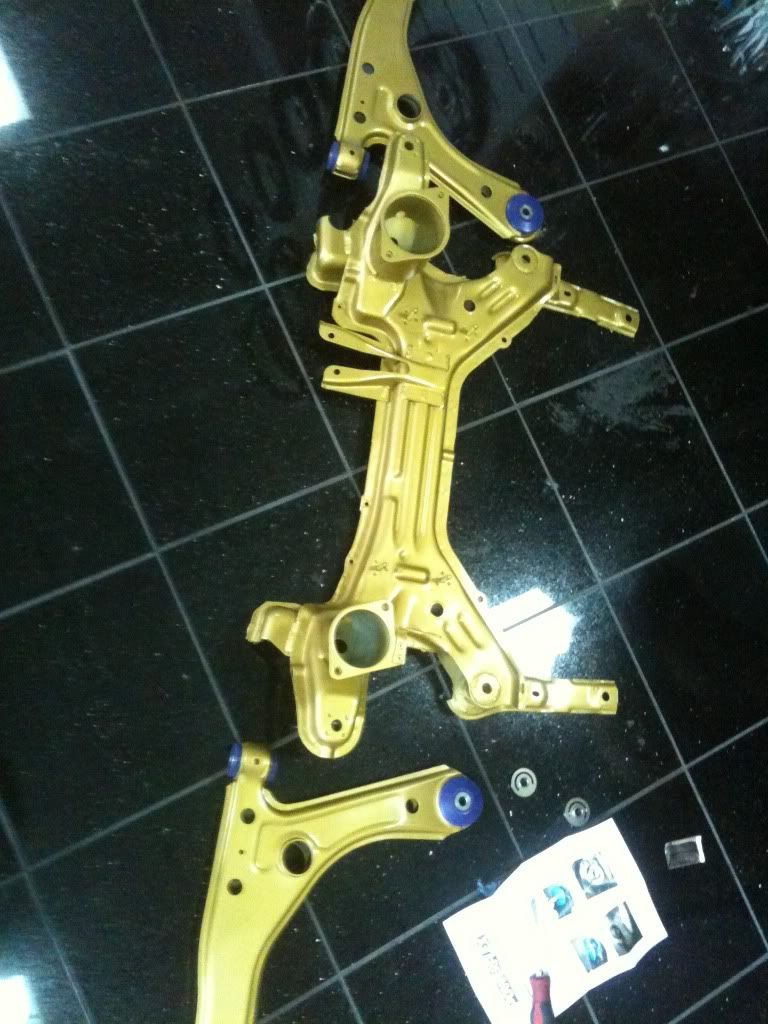

I have mixed & chosen this colour as our signiture under chassis parts paint colour, all I can say that this colour has a crazy amount of pearl in it

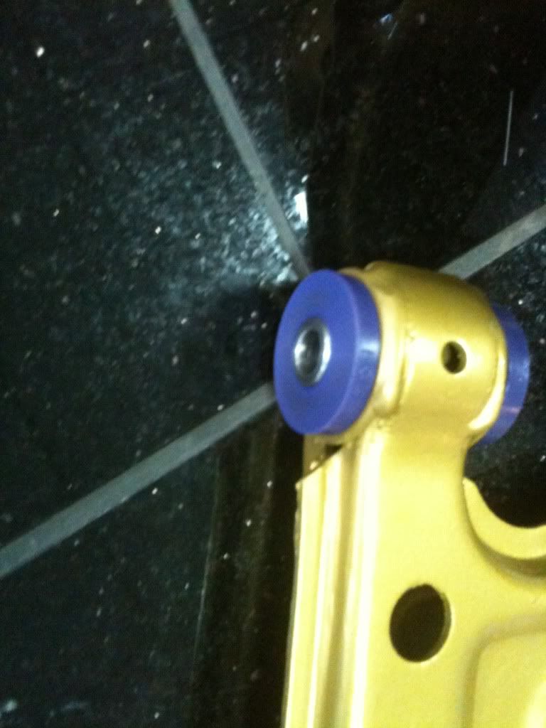

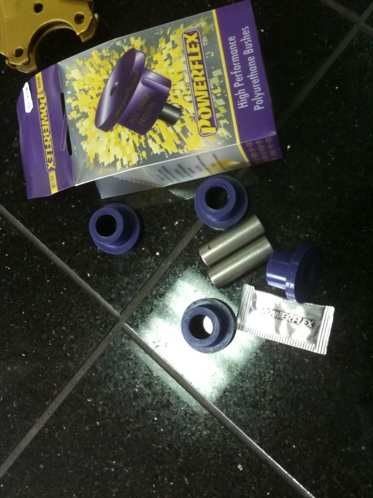

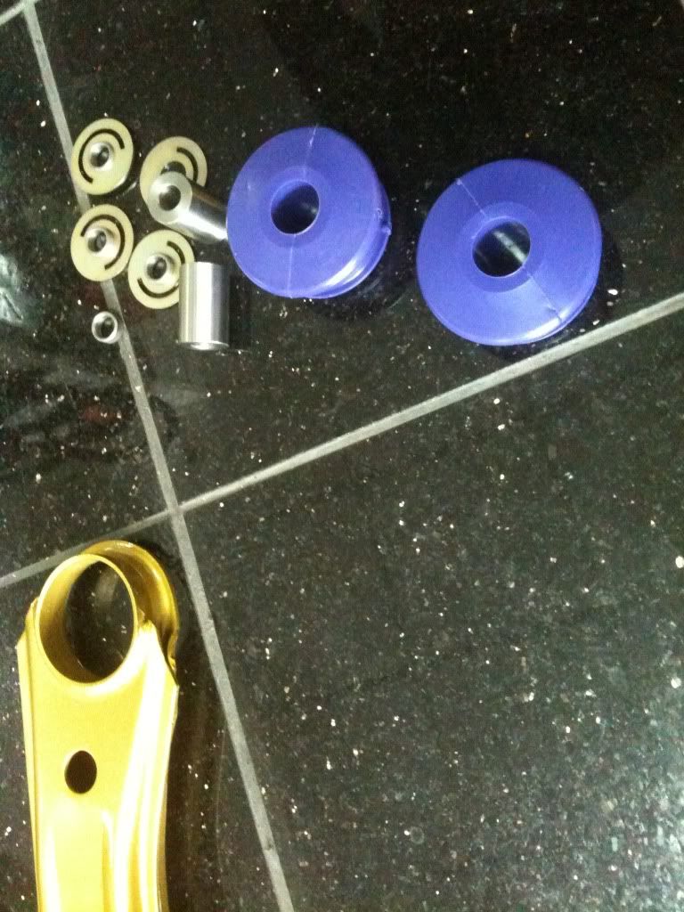

As we have this all stripped up it was time for it to get Power flexed up, If any of you want powerflex bushes at a very good price, drop me a pm & I will see what I can do. I keep most of the popular bushes in stock especially the golf range, try me
Now just awaiting for the rest of the components to be done, I will get round to it tomorrow.

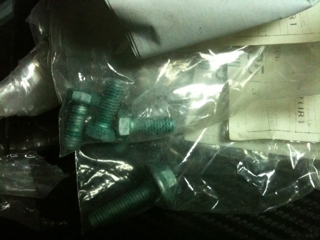

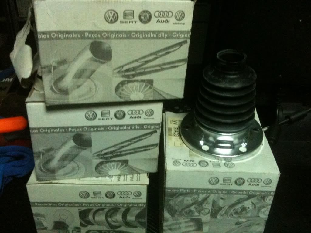

Genuine inner & out c.v boots

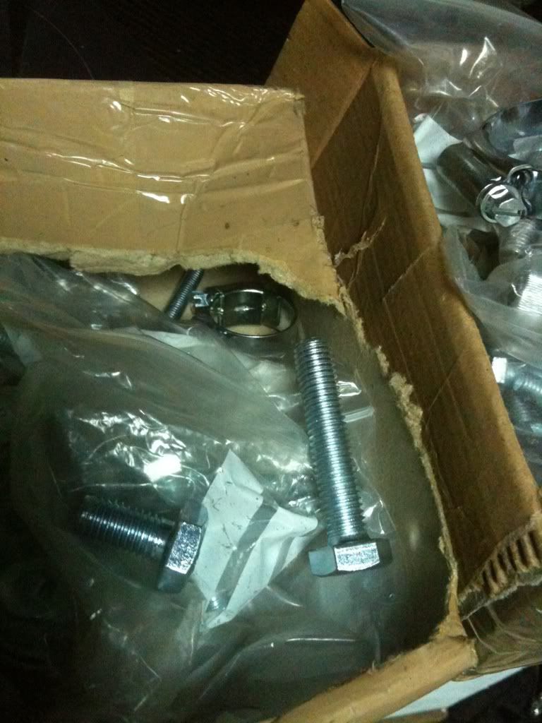

Genuine bolts
Nice & shiny bolts for the rest of the bay that you can see

Great work on the lights,whats going in the other half of the lens thats now all black?

Thanks, the other half is still the orignal Mk3 part of the light. This will still work as a normal main beem.

« Reply #119 on: 24 May 2011, 22:59 »
I love the amount of effort that went into the lamp, but..........!!!!!!!!!!!!!!!!!!!!!!!!!!!!!!!!!!!  :undecided: :shocked:
The headlight beam pattern from the dipped beam (projector) may be scattered all over the place.
The OE projector generates the right beam pattern in the first place, but the mk3 glass is diffusing it afterwards. The original S3 lens would be clear I would look out for a clear, non diffused lens to replace it with.
It might be alright, but i'd be putting it on an MOT beam setter/tester just in case  :huh:
