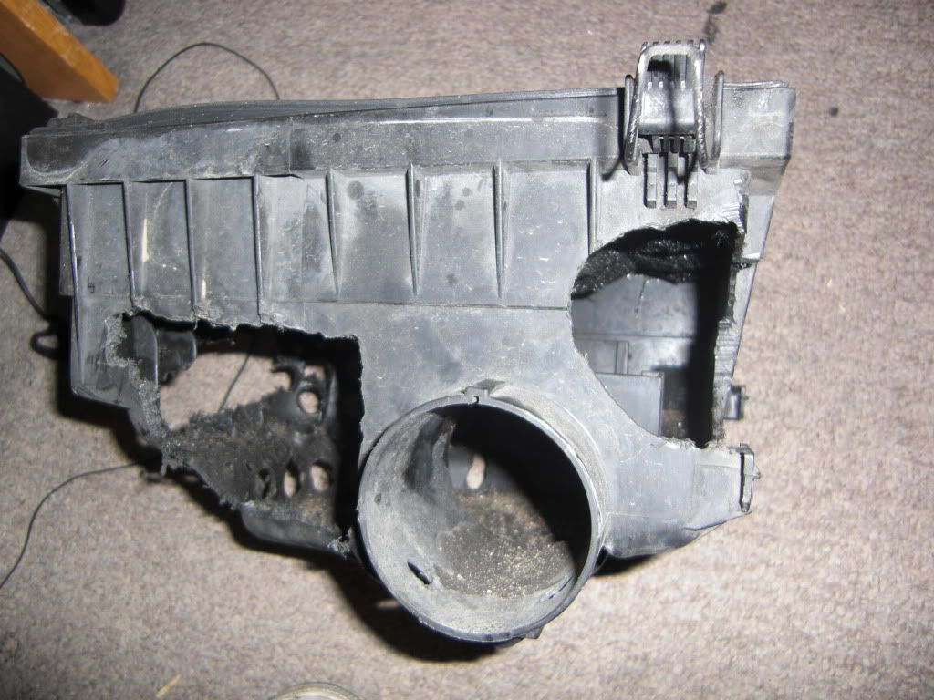

Here's some inspiration.
The pics of the inside of the airbox look very messy, but it's pretty smooth behind there and it made good power on the dyno  :smiley: :smiley:
Re: Air Filter
« Reply #5 on: 08 February 2011, 20:40 »
Drilled airbox and panel filter is the best option.

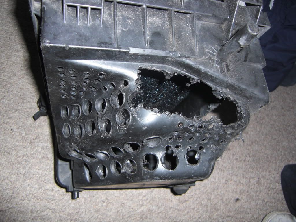

Oh and this one too
Offline on-the-rampage
  • Posts: 123
Re: Air Filter
« Reply #7 on: 08 February 2011, 21:00 »
thats some air box man awesome
