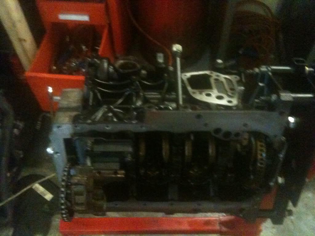

Issues developed: Started to use Mobile1 oil and same day oil pump failed and and made a mess of number 1 rod, sump and block.  Brand new Oem clutch slips with 265lbft during launch when shifting to 2 second gear at 7800rpm.

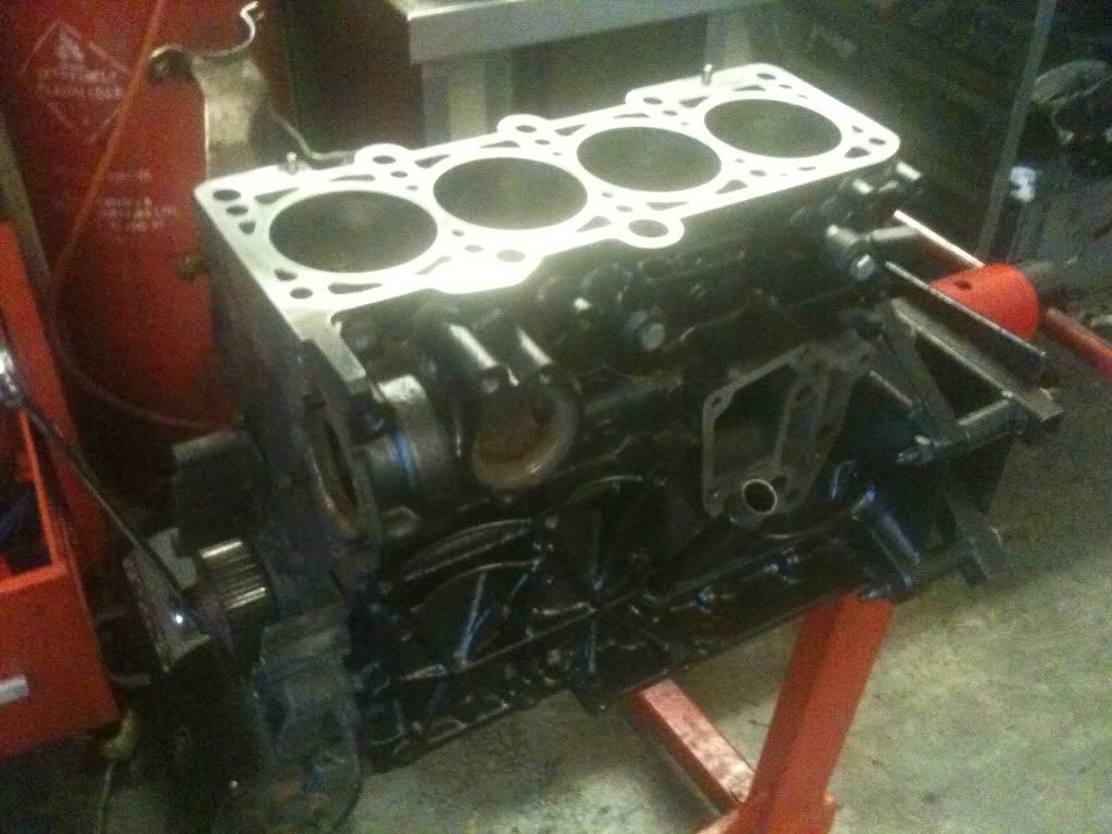

Engine stripped and 85k block found on ebay, new engine fully stripped painted and rebuilt using new shells, uprated cod rod, bores honed and 86kold piston  and rings used, new oil pump and pick up.

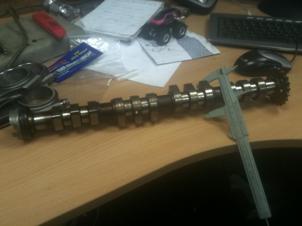

OEM High lift and 202deg 86.4mm duration cam

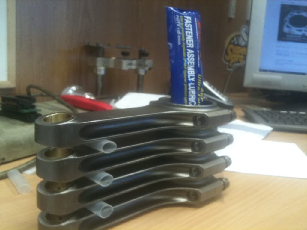

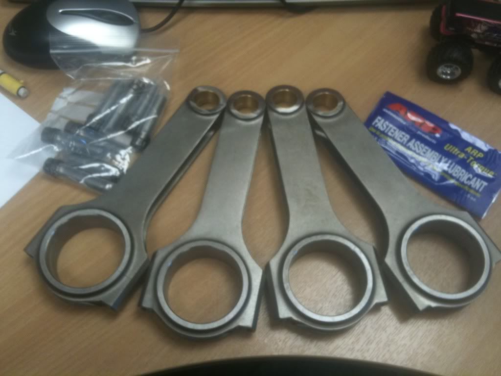

THS steel H-beam rods  & ARP rod bolts landed on my door step and got mock fitted and shells plastigauged
THS 19mm pin rod =  £347.23
OEM Bearing / Shells = £55
