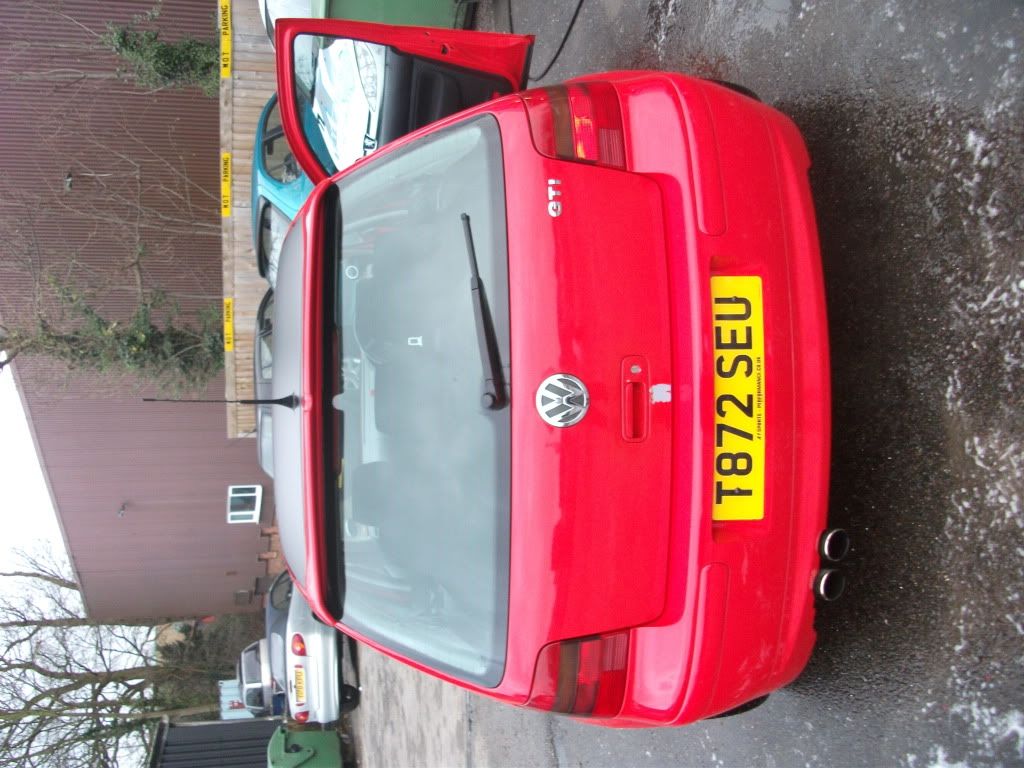

Whilst Washing my car paint flicked off.. pic's!!
« on: 15 January 2011, 21:29 »
 :laugh:
any idea's what i should do? looks like theres rust behind the handle? :\
il get a quote one night next week.. and see what they say,
but im skint now  :lipsrsealed: so might just make up a sticker? cause it really does fook me off as iv had the car cince tuesday  :cry:

I've not had paint come off of mine but my handle is in a similar state. I did a search on it and it seems to be a fairly common problem.

Early water based paint, is sh!te! especially doesn't like to be power washed :lipsrsealed:

Yep, I remember about 16 years ago I was working for a mate valeting cars. I jet washed a Polo and the whole side of red paint came off. I pooped myself!  Was poor quality paint so I was told at the time.

f**k :( aw man!! :( how much do you think it would be to get this sorted? would hole tailgate need doing?

You could have a go with rattle cans, feather the edge   with 400w/d then a little bit of primer, paint then lacquer, probably cost you £30ish from Halfords... a Bodyshop would price it at around £280ish+vat

like u say, a Sticker.

i will give it a measure up today and do some ideals and get LL to get one to me  :smug:
and ill take some more close up pics :rolleyes:
