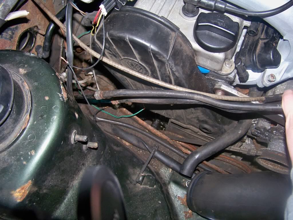

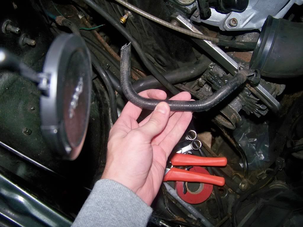

what you do is get the old feed and return lines for the metering head. if you look at the end of them where the threaded fitting is, chop the plastic part off and you'll be left with a pair of threaded fittings with barbed ends. fit them to the 2 lines that come from the fuel pump and push on your abf lines then secure with proper fuel line clips :)

« Reply #6 on: 21 January 2011, 19:04 »
Ill add pics it helps me lol
Thats what on my abf clip bit, so not much
And they are my flow and returns, can I not just bring them over and chop them and put them straight onto my abf clip bit? Bit confused with the threaded fittings, are they what I see in the picture?
