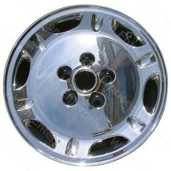

something like this
and there 16" 8j
was just thinking about it because i was looking at porsche alloys and saw these and just wondered if anyone has ever done it

Well lets put it this way, you will have to do some serious modding to the wheels to get them to fit the pcd for the mk2 is 4x100, the offset is 35 to 38 and the bore is 57.1.
Is it that type of style wheel you are after? As they look a bit like porch D90's

fair play mabe not them then
ya mabe somthing like that i am just seeing what's out there and what people have done
