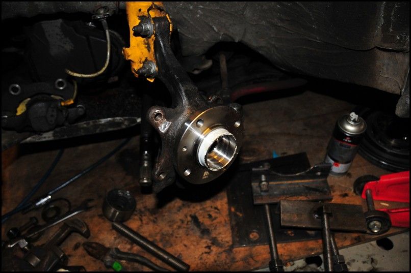

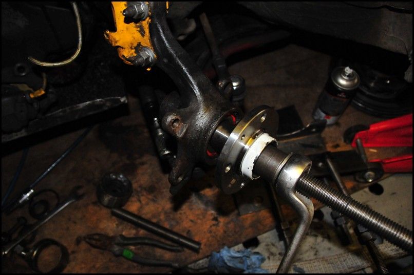

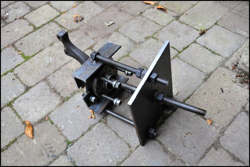

I made one. From parking the car to driving away, I can change a wheel bearing in 45 minutes. No need to remove the struts, suspension geometry is unchanged. If I ever need to change a bearing whilst on a trackday, I can do so and lose less than an hour  :smiley:
I mount the brackets etc to the hub on the car, pull out the old bearing and push in the new one
Pressing new flange into place
New wheel bearing and flange, fitted in situ B)
The `thing`

Lol, that's a neat little tool. I wouldn't have thought you could get the driveshaft out the hub without unbolting either the bottom ball joint or strut though?
Offline Nige
  • Posts: 77
Re: home made wheel bearing press
« Reply #18 on: 07 December 2010, 12:46 »
You are quite right, it needs the bottom BJ popping out of the hub. However, thats one bolts and so long as you don`t touch the 3 bolts holding the BJ to the wishbone, the geometry is unchanged ;)

I like that tool.
Maybe you should make and sell them?
