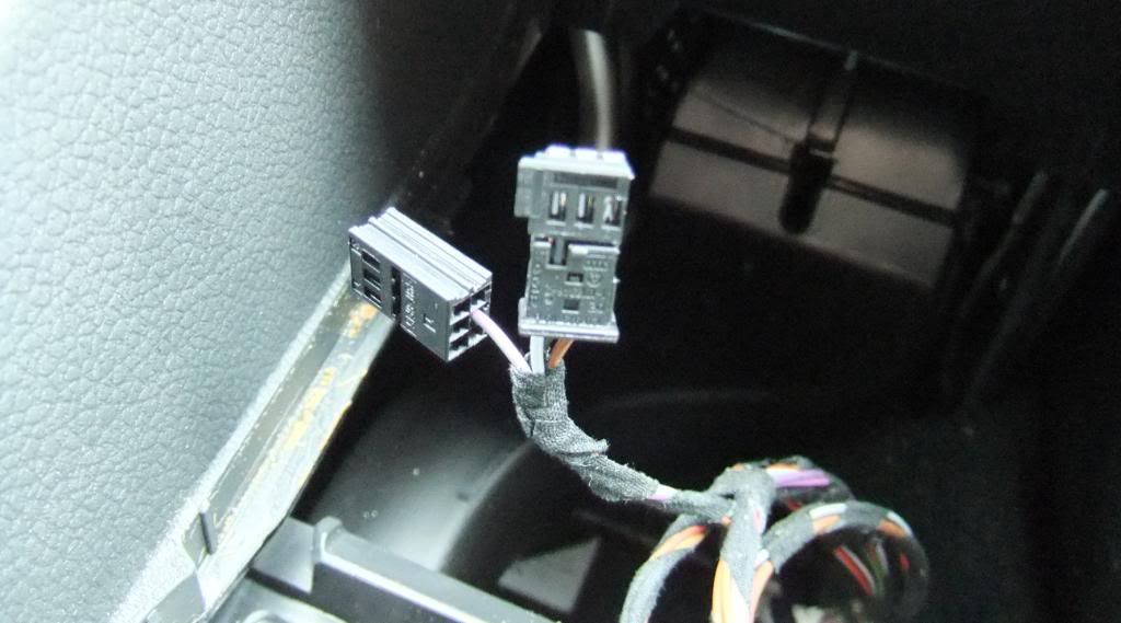

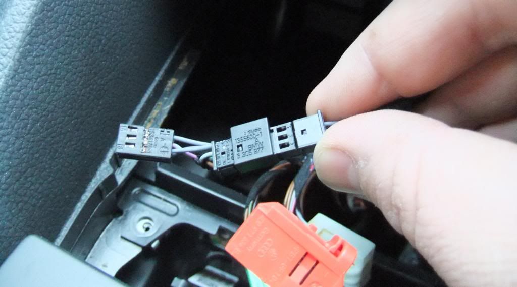

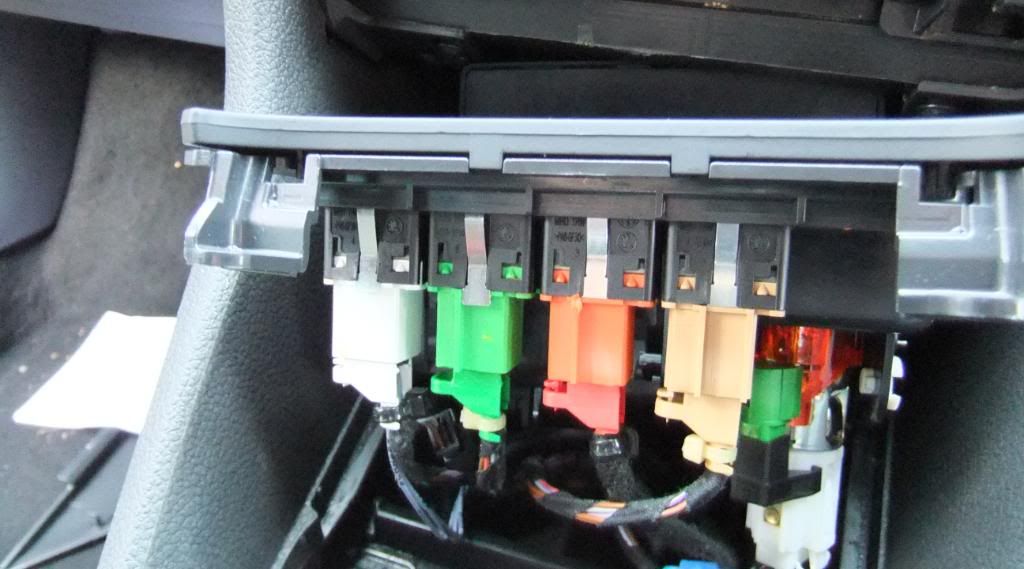

Here's a bit more detail.
Basically it can be installed without cutting any wires you only need to run one wire from the swtich up to the ABS controller behind the battery.
The other connections can all be taken from the ESP swtich and using a combo of pre-made wires and a couple of connector housing it will look something like this: -
Wires taken out of the ESP switch into another connector housing
New loom reconnected to ESP swtich to "pick-up" the required power/signal's
All complete and looking OEM (other than I only had black cable ties and OEM fit is clear)
