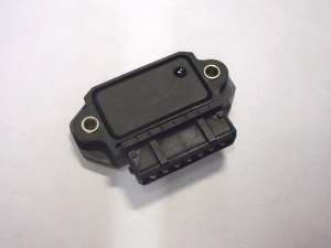

rite i seem to be confused, ive been told by mr rac that this thingy in the pic was the ignition module, the bit that i keep braking is the big black box under the plate this thing sits on, i thought it was an ecu but was told mk2's dont have them and it was an amp, sorry for the confusion,  i replaced this as mattrer of course off of ebay but the old one still worked fine, the bit thats blown has a vacuum hose on it too if that helps
 cheers
Sounds like an ECU to me.
