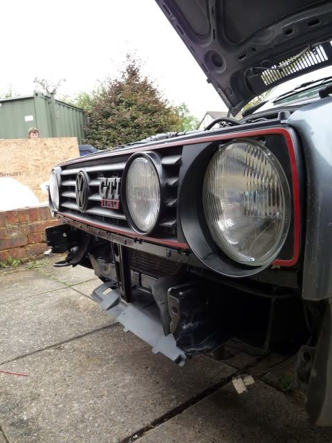

Grill is on and started to take shape!

Looking great, the only downside is I want to do the exact same to my engine bay, but have no knowledge how to. haha
Jimmy bit of time, effort and money you can do anything you want mate, but if you use it as a daily its more difficult! You can do it on the cheap I did! :wink:
