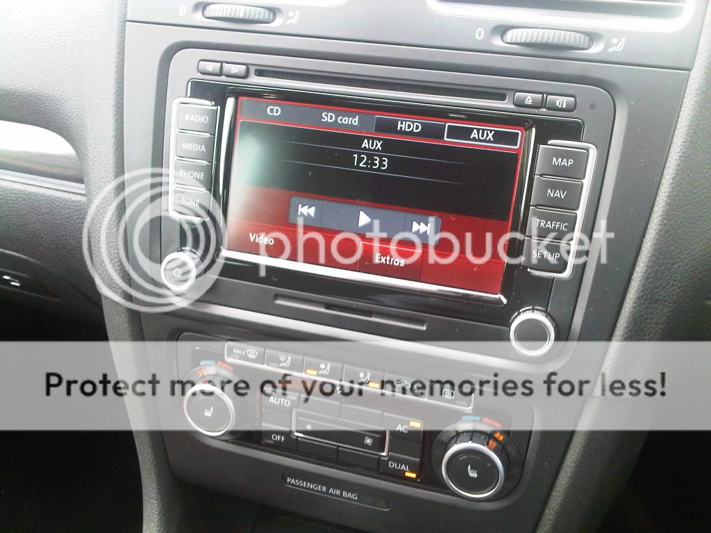

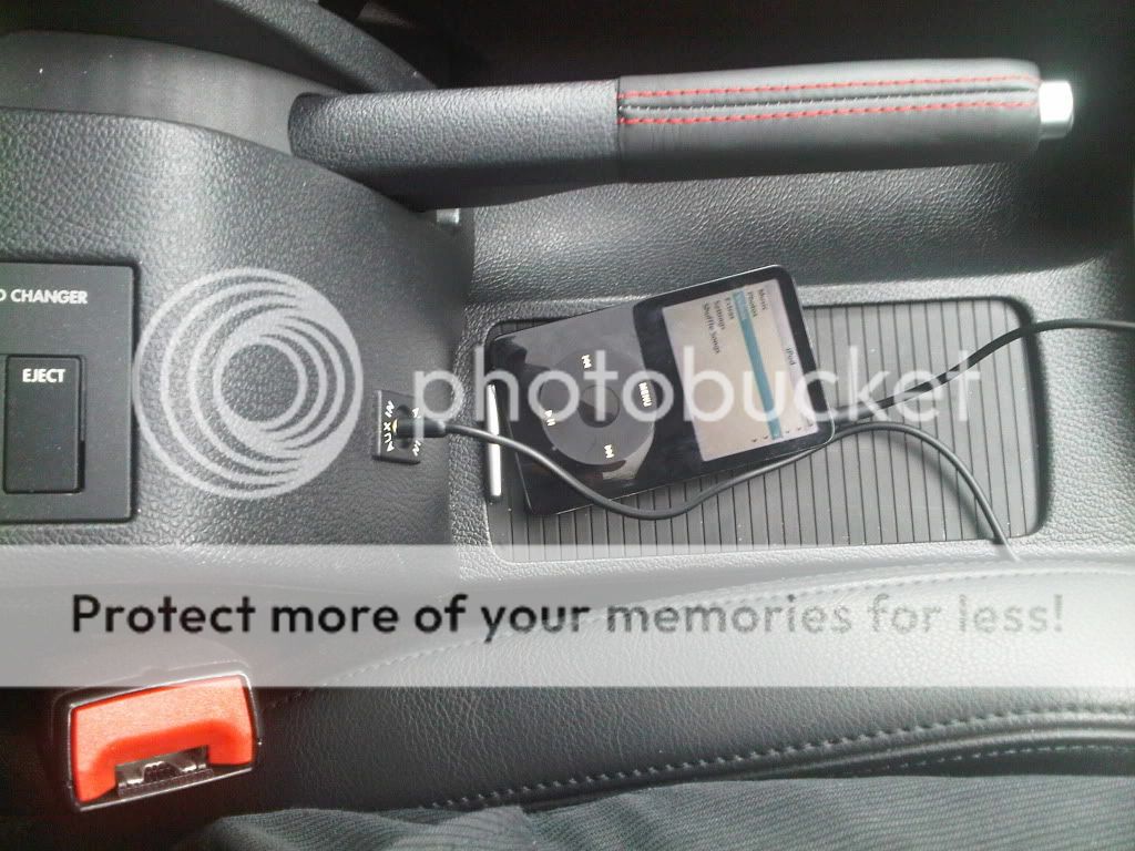

This has been bugging me a while. As per the pictures below, my Ipod is connected the RNS510 through the AUX in. However no track names are displayed on the head unit and I can't change tracks etc on the touch screen? Is this the norm? At the moment I just change tracks and albums on the ipod.
I've tried resetting the Ipod but no joy. Any ideas?

Yes that's normal. If you want to control the iPod over the RNS you need the MEDIA-IN.

Do you not have the ipod connector in the armrest Martin? Should be standard fit in the GTI, but it's not unknown for them to go missing before the car is delivered. You can buy new ones from VW.

Under my armrest is a 6 Disk Autochanger which you can just about see in the photo. I guess here in lies the problem as there is no IPod connection present or MEDIA-IN interface :cry: I'd rather have this than an Autochanger tbo as I don't really play CD's in the car. Oh well that's annoying really but I brought the car X-Demo and therefore that's how it came.
