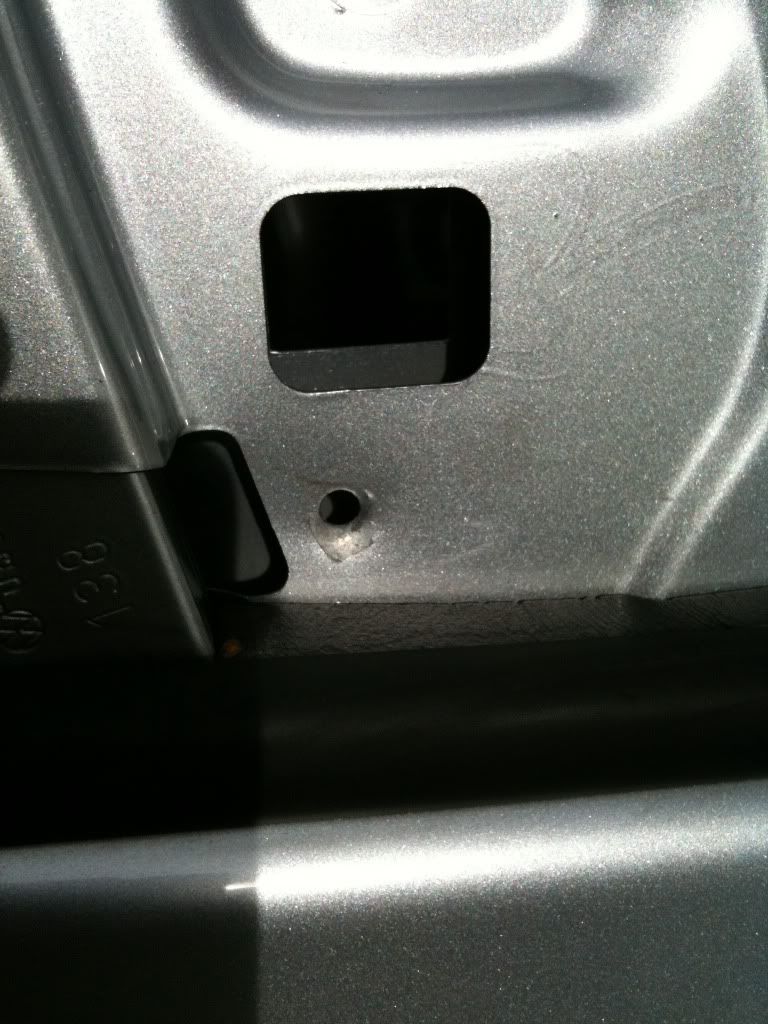

Had to replace what I thought was a damaged wing mirror base after a coming together with a motorbike in London a few weeks ago.
However it turned out to not really require the mirror base as it was part of the door frame that had been damaged  :embarassed:

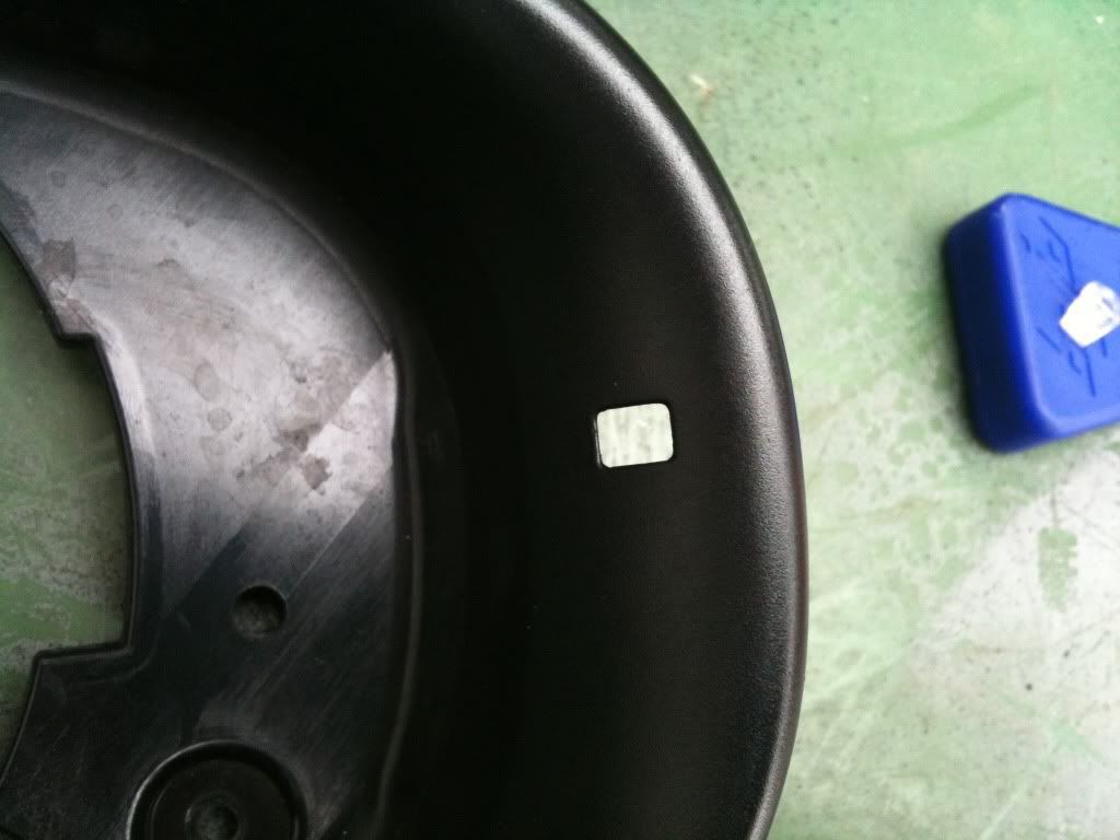

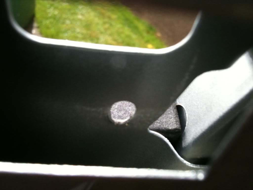

The mirror is only held in by a single bolt then two pins locate the bottom of the base, the point where these pin locate where the problem
This caused the mirror the rattle and vibrate at speed.
You can also see from the inside how the cheap flimsy metal had just folded  :sick:
Typically as my car has the folding mirrors with puddle lights the base wasn't cheap (£123 + VAT  :shocked:) the only plus side was that part of the lens for the indicator had cracked and broke off (just the end that shows through by the mirror side)
