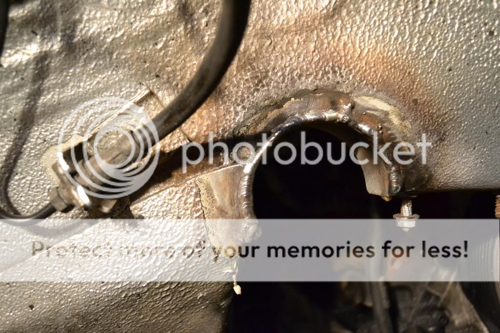

We started on the notch last night, well we I say we I mean barry. So big thanks to him.
76mm hole saw and 76mm OD 3/4mm thick steel pipe.

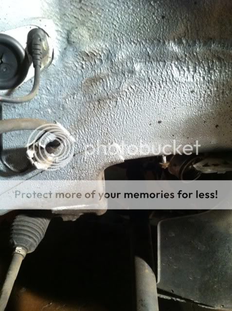

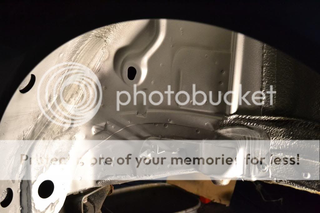

Been working on the car most of the last two weeks and got a good bit done still a long way off but im in no rush and not going to put myself out.
started to clean up the rear arches didnt think they where that bad till I got in there with the wheel.
Did them with Qrust and have since gave them a lick of zinc primer.

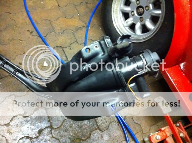

Just leave me to seal the seams again then I'm going to wax the whole inner arch. I also removed the tank and made a start at any rust spots under the car its not that bad just a wee bit round the rear exhaust bracket. While the tank was out i gave it a light clean up.
One of my mates called round today and made a start on welding in the bar for the notch will grind back the welds this week.
