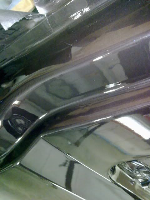

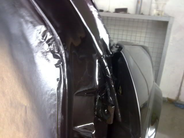

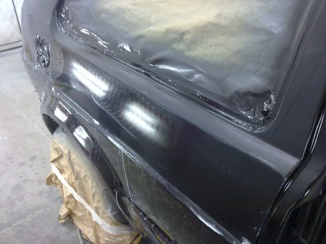

I have painted the last few bits now and had a day and a half of flatting back and compounding. :smiley:
Even managed to get the front bumper and an arch on the car.  I cant be arsed to change the colour on all the photo's anymore so the following ones are correct  :grin:  I played a trick on you and the ones posted before were of the car when it was pre painted to show up any imperfections. :evil:
These are the pictures that had me sold on the paint:
I wanted something subtle but interesting, and being close to the original colour made the job easier.
The car in basecoat:
Zeus:
After 3 coats of clear:
The repair area came out spot on :cool:
Well happy with it!

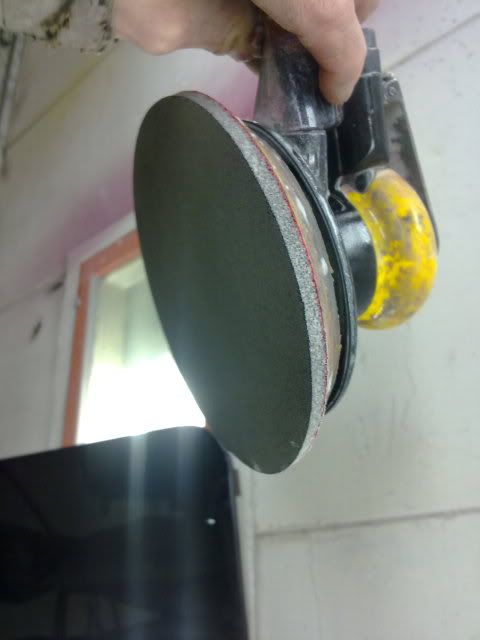

I flatted the whole car back with p2000, then went over that with 2000 grit Abralon pads and then 4000.
good old G3
then G10
I will finish it with a final glaze once the door ect are on as its bound to accumulate a few marks!

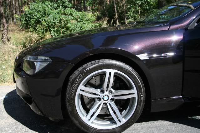

Its called Ruby Black or Rubinswartz.The car looks black in dim light, but once something bright hits it, it flares up deep purpley red... ummmm!
