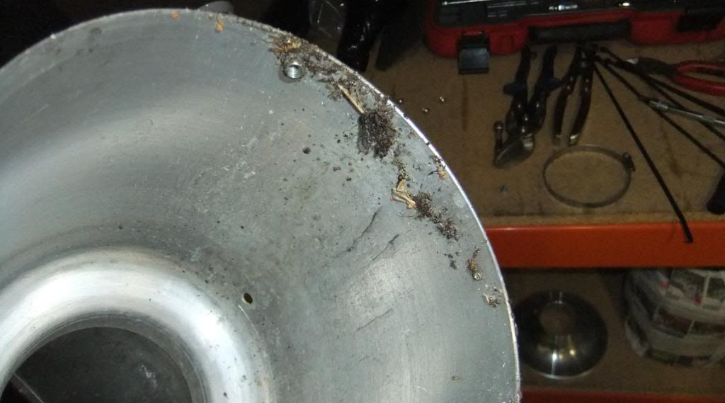

First up more of a completion to an existing mod, the final production version of the ITG intake  :cool:
And to prove how well the kit works, 16k miles use =  :shocked:
And behind the filter nothing but clean and dry pipework  :nerd:

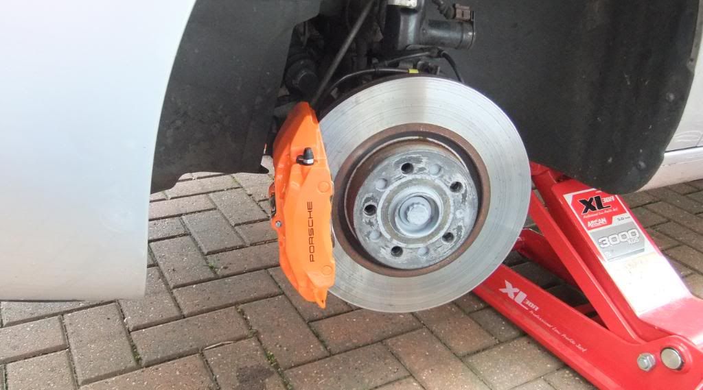

Next up was the new and improved Porsche Brembo 4 pot brake upgrade, refinished in custom orange  :smiley:
Really pleased with the brakes, a great upgrade for the money  :smiley:

I choose the orange to offset against dark colour of the wheels  :laugh:

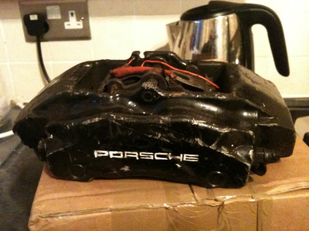

This is how the calipers looked before the refurb

I picked the calipers up cheap on ebay for around £190, then the refurb inc new seals and outer pipes, fitting kit and new pads was another £400, so a Brembo four pot BBK for less than £600, which compared to the normal Brembo 4 pot GT juniors aftermarket kit that sell for nearly double that, I think it a great way to do it  :smiley:
