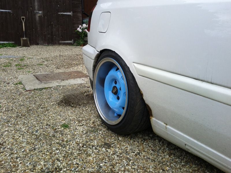

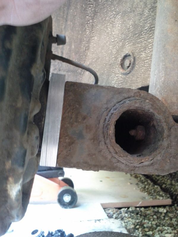

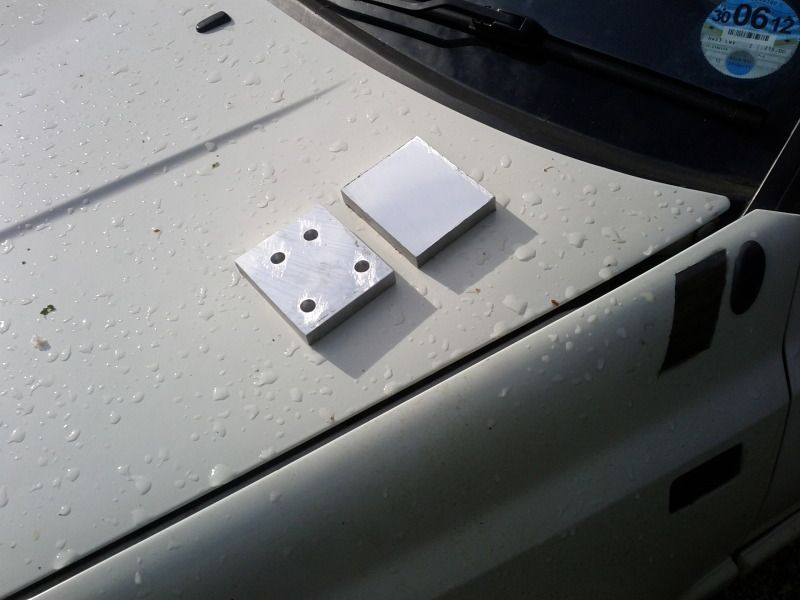

spacers are on, 15mm thick
i spaced the hub rather than the wheel as i could make them myself, cost me just over £10 for the material and bolts
wheel pokes just a little bit  :)

Nice to see a bit of initiative used once in a while although i'm intrigued as to whether this way of spacing the axles out is any stronger or safer than the conventional way of using spacers between the wheel and disc face. Obviously you had to use longer stub axle bolts, i hope they were high grade one ie. 12.9 as i should think the forces against them have just been increased considerably.

the bolts are 'BZP' high tensile steel, i was advised that they would be strong enough, opinions welcome though?
i decided to space the hub rather than the wheel because it was a lot cheaper and also i wanted to use my current wheel bolts
the spacer options were either a 15mm bolt on type spacer which the cheapest i could find was £120 for a pair, or the standard hubcentric type using long bolts which were around £60... but i then had to run the crappy looking bolts and also had to pay £30-40 for a set of longer locking bolts
