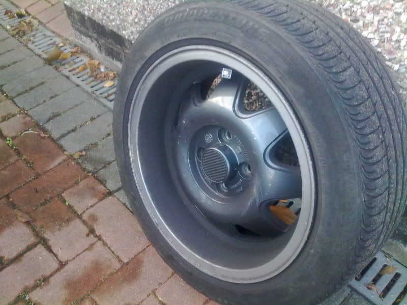

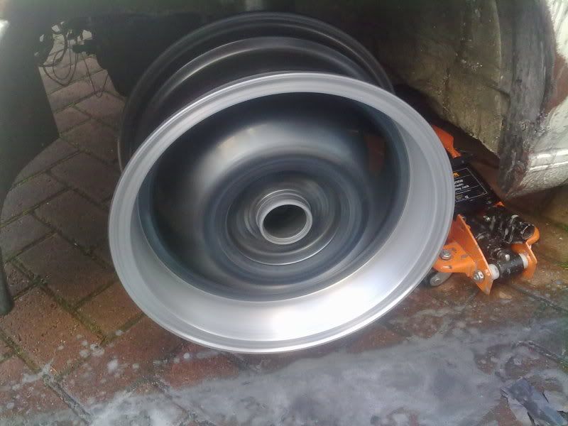

Started refurbing the other set of 7Js last week, going slow though because of weather and i now have a badly blowing exhaust which i need to sort first
heres the wheels to start with, this ones dirty but they are corroded where the laquers gone bad so need quite a heavy sanding to get a smooth surface
tyres and valves removed, jack one wheel up and spin it up in 1st or 2nd, lots easier :P

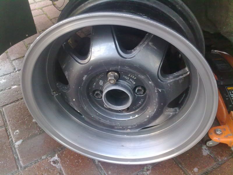

after the 240G sand, still need to sort out the curb marks and then sand with the finer paper

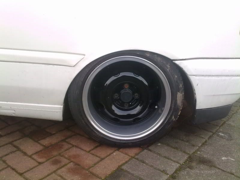

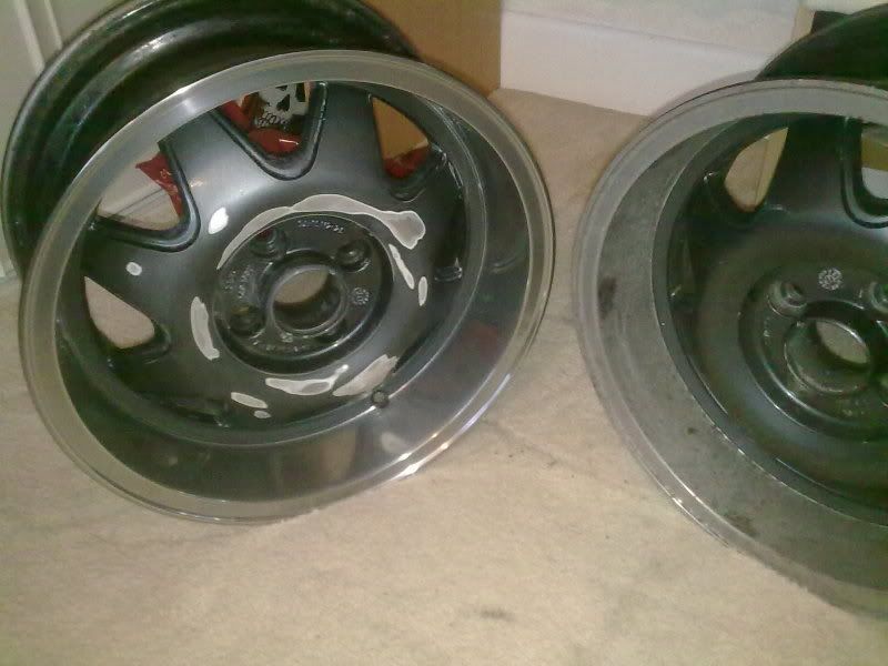

got one wheel sanded, polished and ready for paint, could do with a bit more polishing but i'll worry about that later

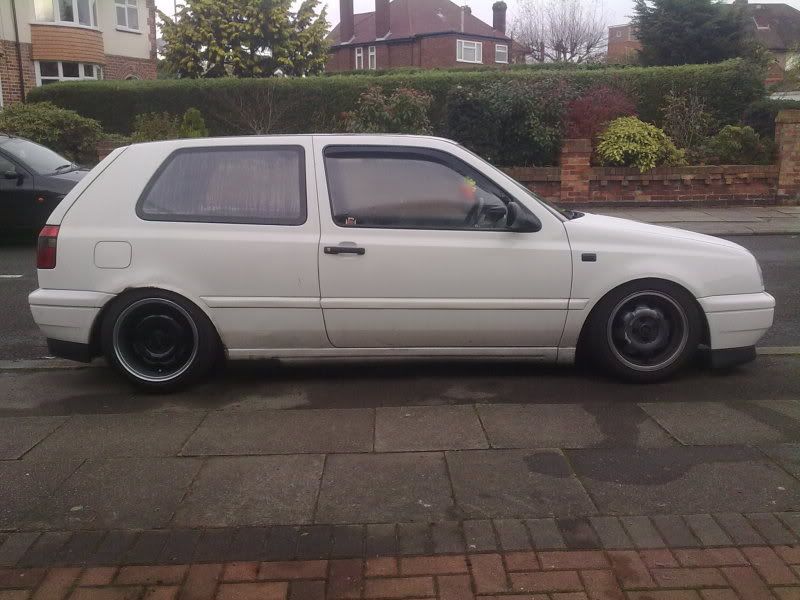

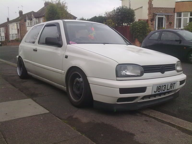

well i've now lowered it 135 on the back so its 120 front 135 back now

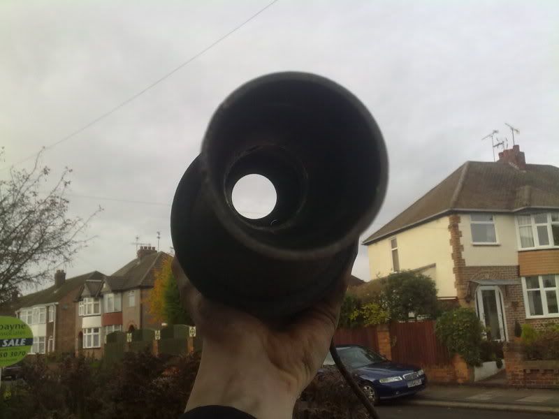

and today i did a de-cat
When the front was jacked up the rear sat down alot, i could go this low without any rubbing   :grin:

Looks good lowered more, have you drove it since then? i want to lower mine buy i dunno if im going to get stuck on speed bumps?  :grin:
Offline rcsammy
  • Posts: 389
Re: Sams Scruffy Mk3! *coilys, cups, colour coded!!!pg17-
« Reply #178 on: 23 November 2011, 18:00 »
yeah its fine, people said the rides not any worse than before in the back
and it sits pretty level, the front hits on some speedbumps but the back clears fine
