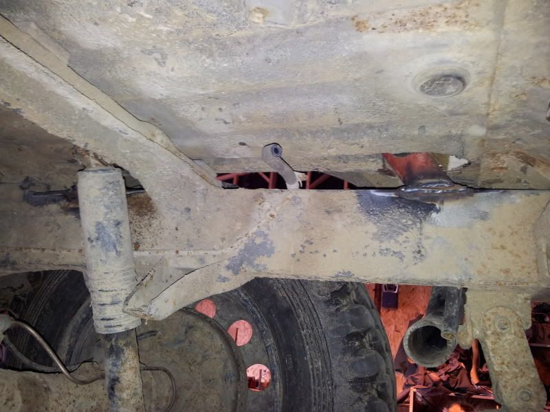

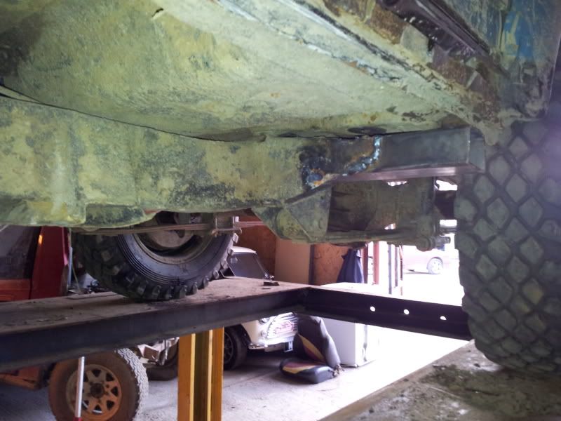

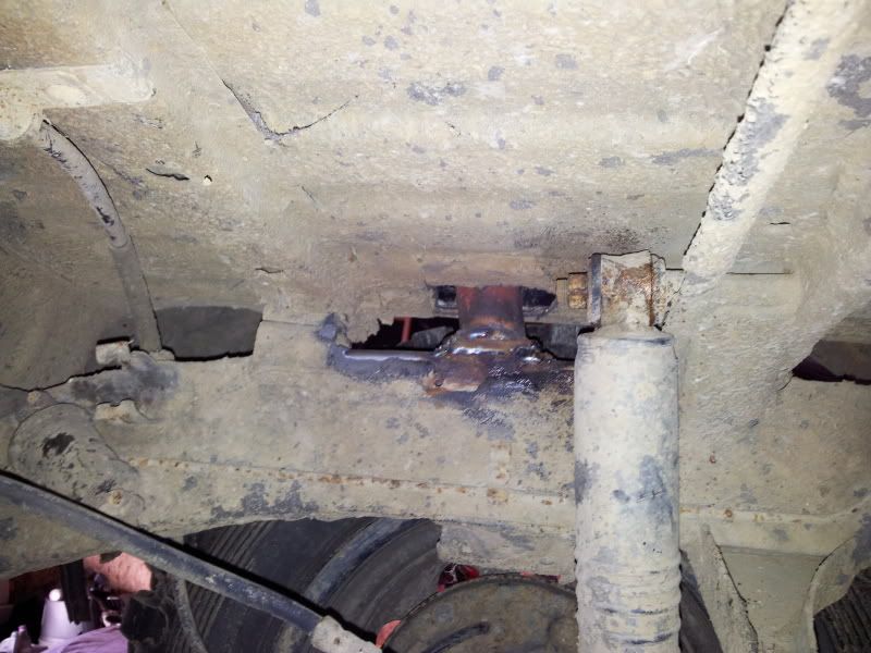

More progress today:
Here's the cage installed, so far:
Here's the front mount, which still needs more gussetting to finish:
The bit you can't see it the tube coming down through the body, to this mount.
Here's the rear stay mounting:
You can see the bottom line of weld, which is the reinforcing plate, then the next line is the weld that fastens down the stay.
This is the mid-stay, both of these were shorter than the front and rear ones, as I think I already mentioned.  This is why it's not pretty, but it's to-spec and should be fine in the event of a roll:
